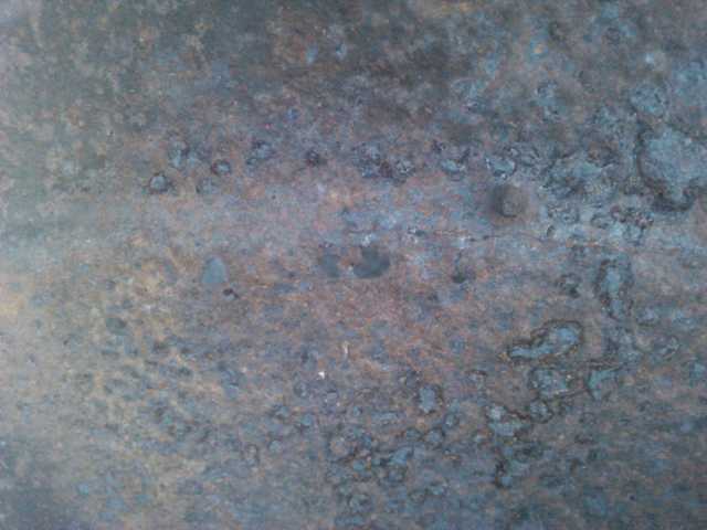

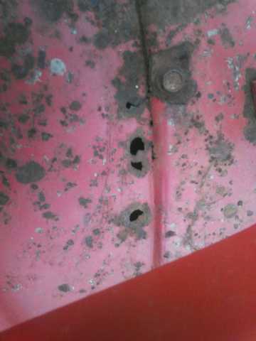

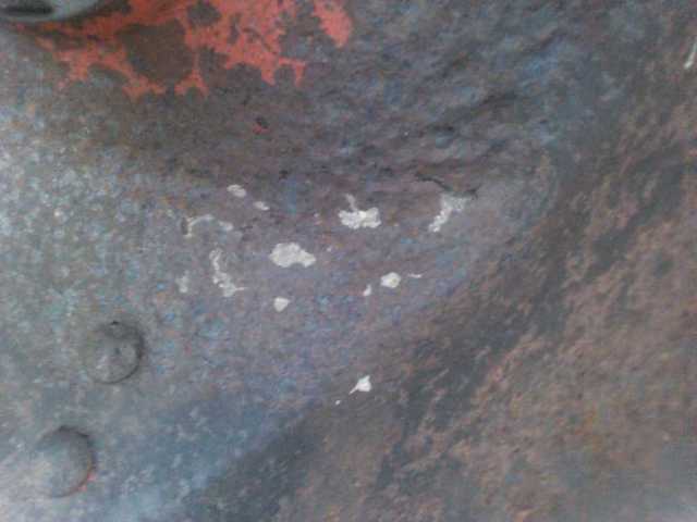

Docwheelhorse 2,992 #16 Posted April 28, 2016 Pics as requested............ 1 Share this post Link to post Share on other sites
cleat 9,384 #17 Posted April 28, 2016 That is bigger than pinholes. I would recommend getting patches welded in. 3 Share this post Link to post Share on other sites
clip 185 #18 Posted April 28, 2016 Patches would be best for that. The corrosion is over a broad area so welding up the holes themselves would be more trouble than cutting out to good metal and putting new in. Alternatively, you can probably make it another 10 years with it in that shape and not have it make much of an effect on cut! Share this post Link to post Share on other sites
Docwheelhorse 2,992 #19 Posted April 28, 2016 Okay... can I go back to my original question then... Do I paint then fiberglass then paint or can I clean very well, fiberglass then paint. Structurally the deck is fine... I'm trying to stop the corrosion. Cutting welding and repairing is not needed---I'll save that for a '66 Big Block Chevelle (which I don't own but want someday...) Tony Share this post Link to post Share on other sites

cleat 9,384 #25 Posted April 29, 2016 According to the TV ads, you could practically build a deck with that stuff....... When I see all those holes in the deck right over where the left side of the axle connects I wonder if it may be getting weak structurally. That is why I recommended getting a patch welded in. When you see all the welding that was done to my deck in this thread. That cost me $150.00 Canadian to a young man in an a welding apprenticeship. Yours should be less and that repair would last. Share this post Link to post Share on other sites
