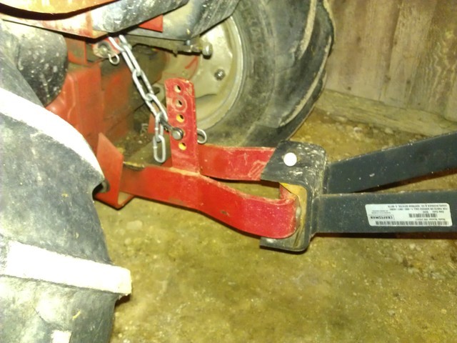

WVHillbilly520H 10,379 #13 Posted May 4, 2016 The cable tube (red metal not seen in first pic) should be along the fuel line and hydro dipstick and then the rockshaft sits in the hole on either side of the fender bracket next to the dipstick tube 1st pic also with the chain for a clevis hitch(second pic) ,Jeff. Share this post Link to post Share on other sites

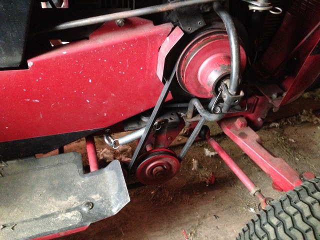

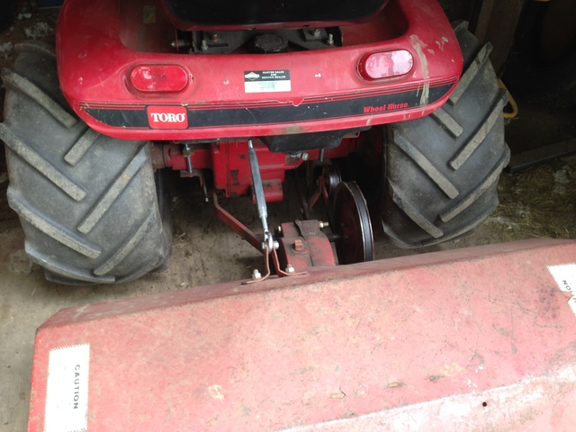

mabsoon 60 #14 Posted June 4, 2016 OLD POST HERE! Thanks, will have to check that out when I get.a chance. I know I have a cable coming out the front side of the hydro with a long thin slotted u shaped bracket on it. It almost reaches a two holes bracket by the deck lifter bar. i meant to reply this when you had posted yours. I forgot to hit submit. Sorry, I don't see what you show in the pics. But here's what I have. Need to know am what I need to pull off and what I still might need. Old post here!!! Just started to post a new and saw I had not published this one. Now the fact that I got no reaponse makes more sense Share this post Link to post Share on other sites

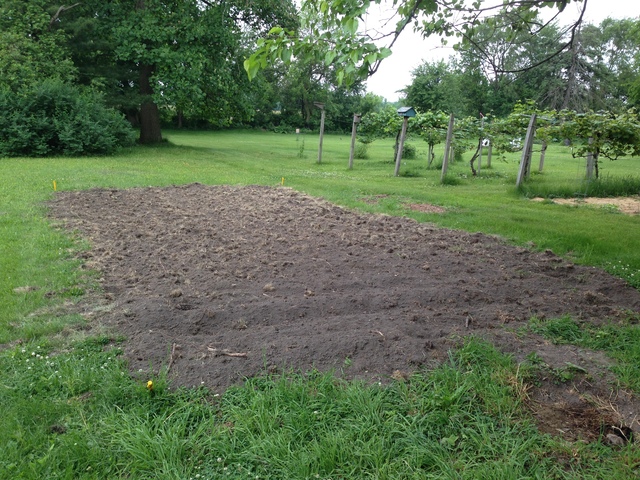

mabsoon 60 #15 Posted June 4, 2016 (edited) UPDATE!!! The garden is turned from Virgin ground. It did take some hydro lever manipulation, though I found it better to use the brake and only occasionally bump up the lever. I did have a problem with one side of the attachment rod coming out when I lifted the tiller. This in turn usually threw the belt. This shut me down the first time it happened because I put the belt back in the snow thrower groove and it kept throwing the belt right when I ingaged the PTO. This was frustrating since I had tilled 1 1/2 passes and then ... I figured it out when I did some revamping of the spring bolt and the lift connection (turnbuckle). When I went to put the belt on, I realized "I bet I was putting the belt back on that groove!". Thanks again for all your help. I will do another pass with some weight added to my tiller for depth and then back to the newly bladed (Oregan Gator blades) 60" deck. It's patiently waiting for me to try the chain me to the power pole so I can't push away when you try to drive over me. Pole located convieniantly next to my shed. Ok no comments on that last paragraph! Heee are some pics. Edited June 4, 2016 by mabsoon 1 Share this post Link to post Share on other sites
WVHillbilly520H 10,379 #16 Posted June 5, 2016 Mabsoon, hey you did good and you got it accomplished, on the attachment "clamps" some guys use "lynch" pins to hold those closed or a small bolt through the hole or tighten them really tight where you can barely move them by hand, then where you have that turn buckle to lift the tiller I just use a small length of chain like in my pic for the clevis hitch and shorten when transporting lengthen while tilling and tilling depth is limited by the tiller itself (approximately 6") gearcase/ tine shaft added weight won't really help, turn over/mold board plow is for depth as well as a brinley spring tooth culivator still sold at Sears and such and towed/lifted by the clevis hitch assembly, the tiller just really mixes the soil up fine for an aerated garden bed, not knocking anything you done there's more than 1 way to do things just pointing out other hopefully helpful things ,Jeff. Share this post Link to post Share on other sites
