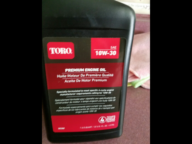

Phatboy 566 #5 Posted April 23, 2016 (edited) Yea guys its the T5 version of the 15W-40 a synthetic blend, and not that is is better than the 30W but i live in Pennsylvania so the multi grade i was thinking in the heavier weight " Might" work well as a year round oil.. In my kohlers i ran straight 30W year round ,, but in my Onan im thinking the synthetic blend might handle the heat maybe slightly better in the rear cylinder , and also the 40W in multi grade might help also just pondering ,,,i have spoke to the original owner on exactly what oils he ran,, in summer he ran "Toro brand straight 30W and in winter he ran 10W-30... So that being said i was thinking the engine is used to a multi grade already so why not just beef up the viscosity a little bit , and run year round,, and he also ran the "Toro" 10W-30 in the hydro,, he sent me a pic of what oil the dealer used ,, as he is a older fella and the dealer did all his maintanance twice a year,,, so hydro oil is definatly being changed to 1 of 2 oils i habent decided which yet,, and im leaning towards this T5 rotella in engine year round,, Edited April 23, 2016 by Phatboy Share this post Link to post Share on other sites
Phatboy 566 #6 Posted April 23, 2016 (edited) Previously used oil by the original owner ,, it is what the dealer used in hydro and during winter months.. Edited April 23, 2016 by Phatboy 1 Share this post Link to post Share on other sites
