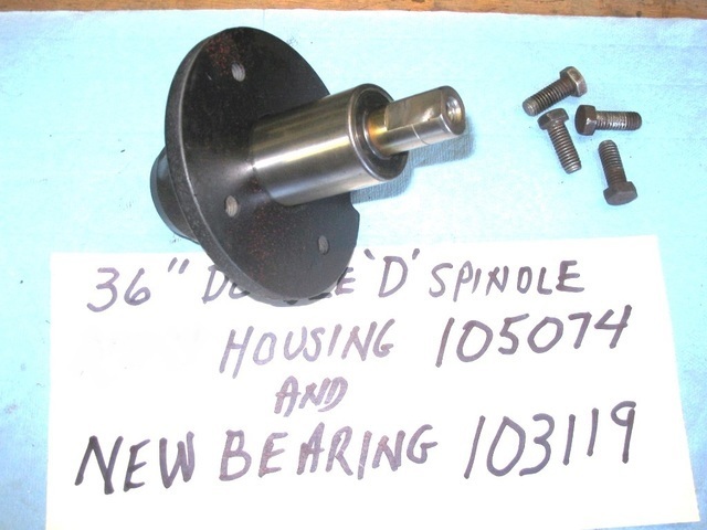

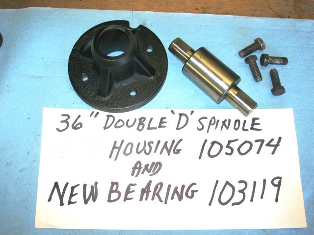

daveoman1966 3,884 #5 Posted April 23, 2016 Your mower deck 5-0720 wants SPINDLE ASSEMBLY # 100675 and I have TWO of them on Ebay at this listing: 131783502802 Here is a pic or two.of them. Contact me directly at the following email address: daveoman@windstream.net Share this post Link to post Share on other sites
82Caddy 851 #6 Posted May 3, 2016 On 4/23/2016 at 10:09 PM, daveoman1966 said: Your mower deck 5-0720 wants SPINDLE ASSEMBLY # 100675 and I have TWO of them on Ebay at this listing: 131783502802 Here is a pic or two.of them. Contact me directly at the following email address: daveoman@windstream.net Those spindles look nothing like the ones I have... Anyhow, I figured since one spindle was locked up tight might as well see if I can get it apart. Little bit of heat and some persuasion with a punch/press and it was apart. You could actually read the numbers and markings on the bearings. I took a bunch more pictures but this is the only one I have that isn't blurry... There is a needle bearing, JT-1213 in the bottom (near blade) and a ball bearing, 22612-88 (at the top near the deck). I ordered 3 of each so I can replace them all. Apparently there is a snap ring in the center of the spindle, I'm not entirely sure what it's exact purpose is, but I'll have to pick up 3 more of those as well since I destroyed the one I had when I took the spindle apart. Weird thing is there is a rivet in the cast part of the spindle. I think I'm going to drill it out and put a grease zerk on it so I can see if these new bearings can live a little bit longer. Also the electric motor on my air compressor died so until a new one of those arrives I can't sand blast/clean up the spindle housings. 1 Share this post Link to post Share on other sites
