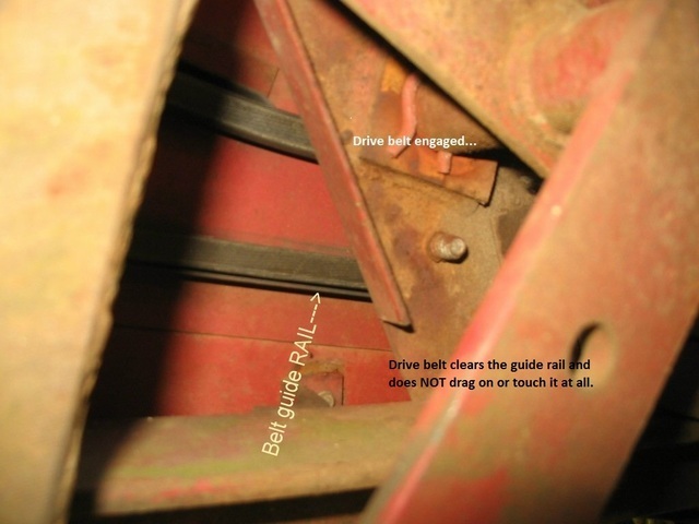

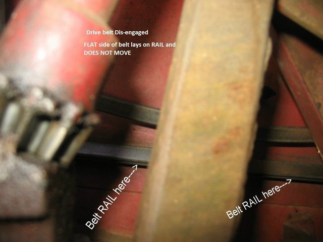

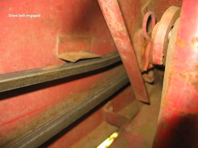

daveoman1966 3,884 #2 Posted April 20, 2016 (edited) There are guides on the back-side of the belt cover to correctly carry the belt. Hope these pics help.Look closely at them as the clearances are close. At least, this the way my C-160 Auto is arranged. Edited April 20, 2016 by daveoman1966 Share this post Link to post Share on other sites
