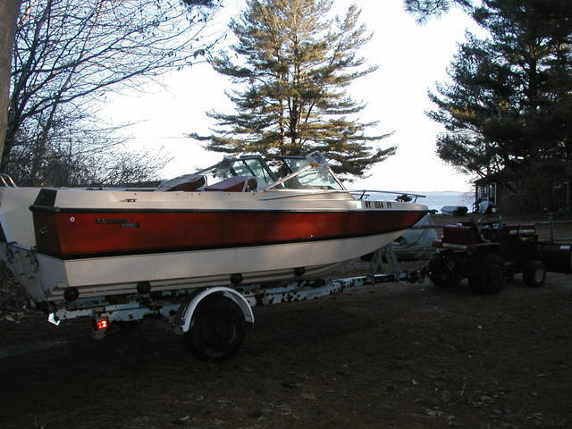

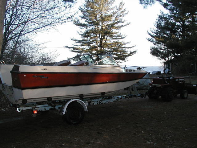

JackC 619 #6 Posted April 20, 2016 I have two 1977 D-160s with the twin cylinder ONAN engines and a 1978 D-200 with the big Kohler twin. I have had good luck with all 3 engines. One of the ONANs needed a carburetor cleaning. I would swear it needed an engine overhaul but the carburetor cleaning made it start and run like new. It also needed a new starter so it must have a few hours on it. I like the smoother running of the twin cylinder engines. I am not sure why Wheel Horse switched from the single cylinder Kohler to the twin cylinder ONAN for the D-160. I know they did it for the 400 and 500 series tractors because the ONAN engines have more torque at lower RPM. That was important to be able to put a 60 inch deck under the 500 series and not have the engine stall at lower RPMs when the deck is engaged. The big Ds grow on you if you have the room to store them. I keep them on pressure treated platforms with double tarps over them. I use them for plowing and general pushing and pulling. My D-200 has less than 400 hours on it. The PO sold it because of a motor to pump spline problem that I was able to fix. My boat has been in storage for a number of years and I used the D-200 this past weekend to pull it out so I could work on the boat. The D-200 pulled like there was nothing behind it. The boat is an antique also and the same vintage as my Ds. It is a 1977 Browning Mustang waiting for a new to me 140 horse Johnson that I picked up for $300. Note that the boat is the correct color to be pulled by a Wheel Horse. The trailer needs paint but I may swap it for a galvanized one and skip the work needed to refinish it. The lake is the Sacandage in upstate NY. Share this post Link to post Share on other sites
