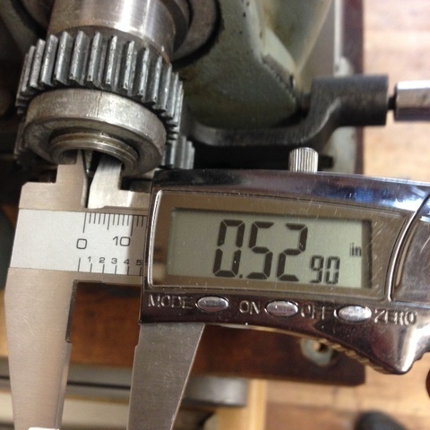

formariz 12,359 #1 Posted April 19, 2016 I am having difficulty locating bearing #1502 for my 1956RJ. Specifically the issue is the one on the pulley side of the cross shaft which should be sealed on the outside and open on the inside. They are essentially R12 bearings but I cannot find one that is only 5/16" wide and sealed. All sealed ones are7/16" thick, therefor standing out from housing and pushing out pulley not allowing retaining clip to engage is shaft groove. Any help greatly appreciated as always Share this post Link to post Share on other sites

formariz 12,359 #8 Posted April 20, 2016 12 hours ago, buckrancher said: slide the chain gear farther on the shaft or cut the side facing the bearing Brian The gear is welded on to the shaft. I could cut the pulley shaft a bit but i will lose the set screw hole. Could re drill it but I will have to assemble the rest of it to see what cutting it will do to belt alignment. The bearing that was on there is a 5/16" open bearing but it had a clever cap over it which I unfortunately lost. 1 Share this post Link to post Share on other sites
buckrancher 2,696 #9 Posted April 20, 2016 know anyone with a lathe cut the weld off and move the shaft and reweld or new set screw Share this post Link to post Share on other sites

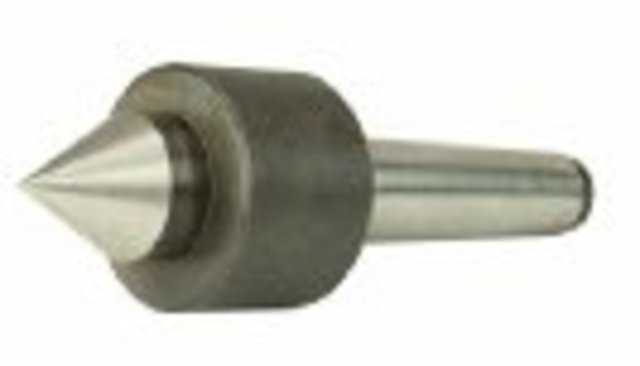

WHX?? 56,006 #13 Posted April 21, 2016 Brian is correct in that the workpiece should be kept close to the headstock if possible for better accuracy. Keep lubrication on the work piece support when using it. Use a live end if you have one. Share this post Link to post Share on other sites
formariz 12,359 #14 Posted April 21, 2016 35 minutes ago, WHX61/3 said: Brian is correct in that the workpiece should be kept close to the headstock if possible for better accuracy. Keep lubrication on the work piece support when using it. Use a live end if you have one. Using the live end however seems to interfere with cutter Share this post Link to post Share on other sites
WHX?? 56,006 #15 Posted April 21, 2016 Rats...the best laid plans of mice & men....maybe a thinner parting tool ground to the angle??? Share this post Link to post Share on other sites

buckrancher 2,696 #23 Posted April 22, 2016 that's interesting you can not slide a 3/4" shaft thru the spindle bore ? what size will it except ? Brian Share this post Link to post Share on other sites
MWR 321 #24 Posted April 22, 2016 (edited) 16 hours ago, stevasaurus said: So you just don't want a couple of good used ones?? Or maybe some new ones from Jake Kuhn?? I have some parts you could turn me out if you want to play with that lathe. 12 hours ago, formariz said: Thank you Steve. I am not saying no, and I may need to get them from you. However I am going to attempt this since I been wanting to use the lathe for so long. In addition to that desire I am also thinking about being efficient with my time. You see, the lathe and the still are in the same room, and I always have to kill a substantial amount of time until the stuff starts flowing. Now, I not only have a reason to try my hand at being a machinist but at the same time I can work on my chemistry stuff or and the reverse order. Its a win win situation one may say. I've just been a member here a month or so, but from reading and watching his videos I've already determined it to be possible that Stevasaurus's middle name is "Bearing". Edited April 22, 2016 by MWR 4 Share this post Link to post Share on other sites
formariz 12,359 #25 Posted April 22, 2016 I think Jim described it accurately as a "desktop" version. It will only let 1/2" through. I have a lot of stuff for it that I am not sure of their function. Which cutter in last picture would be better for this operation? Share this post Link to post Share on other sites
