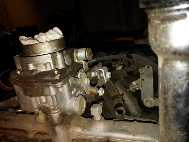

Hates yrd wrk 8 #1 Posted April 17, 2016 (edited) Can someone tell me if I'm missing something on the choke functions or if I have it connected incorrectly. Dose not open or close with dash control. I don't recall removing any linkage from this area. I could be wrong , I have about 4 different motor things going right now. Did this and another carb Friday could have left parts at the shop. So of can't load photo. Edited April 17, 2016 by Hates yrd wrk Can't load photo. Share this post Link to post Share on other sites

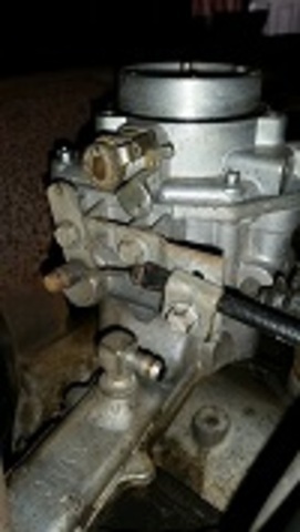

Hates yrd wrk 8 #3 Posted April 18, 2016 I'll try again with a photo. WORKED !! Now, back to my question. Am I missing a linkage rod. At the shop today and there are no extra parts for this carb here checked all over at the house also, nothing. HELP ! I've got something out-a wack. Photo is drastically down sized may be hard to zoo in on. Share this post Link to post Share on other sites
bluebug 27 #4 Posted April 18, 2016 Looks like the cable is coming out of the casing at a weird angle. Try mounting the cable below the screw. Clark 1 Share this post Link to post Share on other sites
ericj 1,580 #5 Posted April 19, 2016 is the little metal rod that goes from the choke linkage to the butterfly on the carb, I've lost 1 or 2 of them over the years, good luck eric j Share this post Link to post Share on other sites

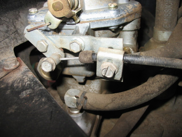

bmsgaffer 2,071 #6 Posted April 19, 2016 Not the best pic, but this should give you an idea. 2 Share this post Link to post Share on other sites

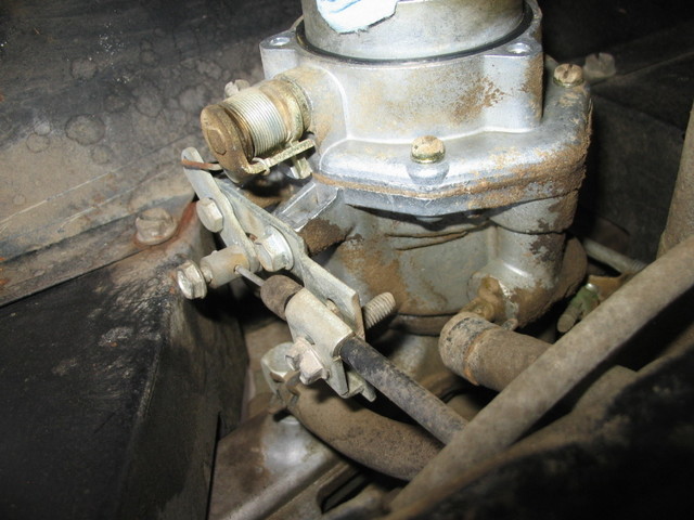

daveoman1966 3,884 #7 Posted April 19, 2016 This is the carb on my 520H... does this help. Closeup of the choke cable..... 1 Share this post Link to post Share on other sites
953 nut 69,066 #8 Posted April 19, 2016 18 hours ago, bluebug said: Looks like the cable is coming out of the casing at a weird angle. Try mounting the cable below the screw. Clark As Clark said, mount the cable jacket below the hold down, should work. 1 Share this post Link to post Share on other sites
Hates yrd wrk 8 #9 Posted April 20, 2016 On 4/19/2016 at 0:56 AM, daveoman1966 said: This is the carb on my 520H... does this help. Closeup of the choke cable..... That's what I was looking for. Thank you Dave. I think rather than ordering one I'll use a piece of stainless tig rod and make my own. Thank you again. Share this post Link to post Share on other sites
