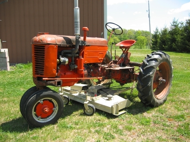

pfrederi 21,231 #4 Posted April 17, 2016 (edited) Yes Woods made them. The deck housing, end plates, skids, spindles and blades are identical to a Woods L59. In was able to find cross references for Woods parts numbers for bearing and seals much easier than the WH #s when I overhauled the one I bought a few years ago.. The L59 was widely used with small farm tractors as a belly mount. I happen to have one of them. Edited April 17, 2016 by pfrederi 5 Share this post Link to post Share on other sites
