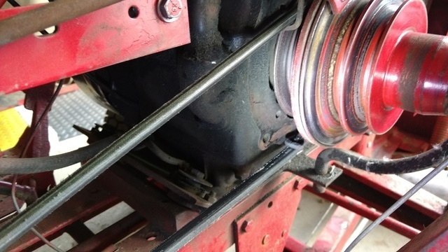

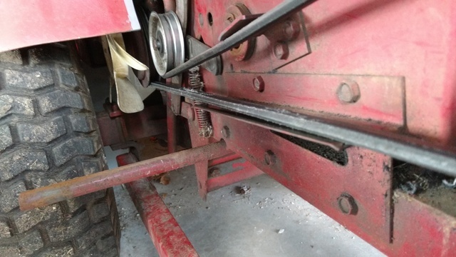

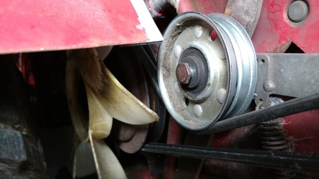

semper5 43 #1 Posted April 10, 2016 I have been having a problem with my drive belt slipping from my transmission pulley. I have a C145 tractor. I have included a few pics to show, maybe someone can help pinpoint why the belt keeps slipping off the pulley? Why is the limit to upload so small? Anyway around this? Share this post Link to post Share on other sites

semper5 43 #6 Posted April 12, 2016 Here are a few pics of my belts, perhaps this may clue someone in as to what may be different. Although, at this point, I suspect I should remove the belt and measure it. Share this post Link to post Share on other sites
Tankman 3,528 #7 Posted April 12, 2016 (edited) Are your belt guides (# 10 & # 14 below) positioned correctly? Huskee Kevlar belts on the shelf at Tractor Supply. They're "green", meaning "oil resistant". Inexpensive. Your belt really appears too long (?). Edited April 12, 2016 by Tankman 2 Share this post Link to post Share on other sites
wrightorchid 261 #8 Posted April 12, 2016 It looks pretty worn, and might just be stretched out too far. Be sure there is no oil leaking on the pulleys, or something in the way of the pulley that applies the pressure, limiting the movement. Share this post Link to post Share on other sites
tbarnhart 240 #9 Posted April 13, 2016 Tankman has the answer. The belt is on the wrong side of the guides at the engine pulley. It should be below the top guide and above the lower guide. 3 Share this post Link to post Share on other sites
farmer 1,081 #10 Posted April 13, 2016 I agree with tankman, I would also add that there looks to be excessive sideways movement on the idler pulley, might want to check that out as well. 1 Share this post Link to post Share on other sites
Tankman 3,528 #11 Posted April 13, 2016 (edited) 4 hours ago, farmer said: I agree with tankman, I would also add that there looks to be excessive sideways movement on the idler pulley, might want to check that out as well. A washer or two would eliminate sideway movement of the idler pulley. While there, hit the spring with a bit of PB Blaster. Shop vac first! http://www.tractorsupply.com/tsc/search/5%208%20in%20huskee%20kevlar%20belts#facet:&productBeginIndex:20&orderBy:&pageView:grid&minPrice:&maxPrice:&pageSize:20& Edited April 13, 2016 by Tankman Share this post Link to post Share on other sites
TDF5G 2,074 #12 Posted April 13, 2016 14 hours ago, tbarnhart said: Tankman has the answer. The belt is on the wrong side of the guides at the engine pulley. It should be below the top guide and above the lower guide. Share this post Link to post Share on other sites
semper5 43 #13 Posted April 13, 2016 Alright gentlemen, it has been addressed. The old belt was too narrow and stretched a bit. New Huskee belt from TSC solved the problem. I also but the belt guides on correctly. I will later take a look at the idler pulley, and add a few washers. There is definitely quite a bit of space where that bolt goes. Once again, thanks for the help ya'll! 4 Share this post Link to post Share on other sites
