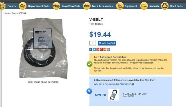

daveoman1966 3,883 #4 Posted April 9, 2016 Rear deck model 05-42MR01 needs DRIVE BELT # 108334 ( 98" long x 1/2" wide). That is from the Toro schematics. The belt is near $20 bux on-line. Share this post Link to post Share on other sites
953 nut 66,405 #5 Posted April 10, 2016 12 hours ago, Tankman said: Hope I got this right, been a long time since I've worked on an RD deck. I'm sure someone will verify my guess.. Mower Rotary spindle belt 6886 Gates 1/2"x86" 4L860W Napa 1/2"x86" 248-086 Stens 1/2"x86" 84860 Goodyear 1/2"x86" Not listed @ Dayco L486 1/2"x86" (.500"x086") This is the one for the three blades on the mower, the drive from the PTO is 98" as Dave said, 4L-980 or A-96. Share this post Link to post Share on other sites
