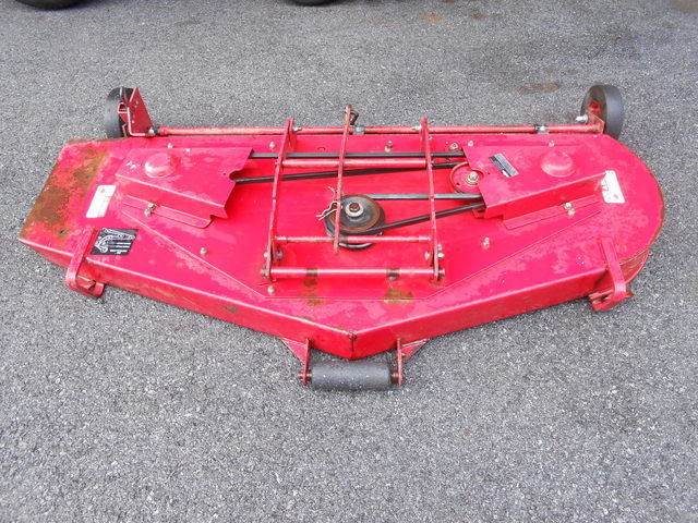

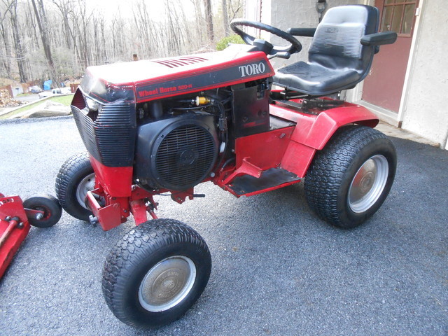

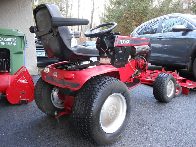

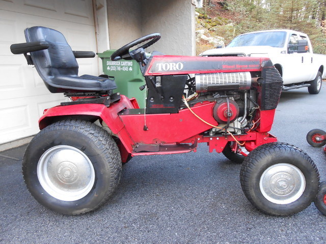

fireman 1,022 #1 Posted April 8, 2016 Posted this in the "What's in your mirror" thread but figured I start a new thread about it here. I happened upon this on Craigslist about 20 minutes after the seller listed it. I called and purchased it immediately. Lets just say it's probably the cheapest I've ever paid for a Wheel Horse tractor. Today I degreased and pressure washed it so I can roll it inside and get it running. The fender pan and hood need some straightening out but that's no big deal. Gonna go through it, change the oil, plugs, fuel filter, hydro filter/oil and see what happens. The hour meter shows 929 hours. 17 Share this post Link to post Share on other sites

Ed Kennell 47,235 #3 Posted April 8, 2016 (edited) Looks great. A little hammer and dollie work and she'll look new. PO might have been DUI to put those wrinkles in her, but may be that's what made her a really nice find for you. And a great looking 60"er. Edited April 8, 2016 by Ed Kennell 2 Share this post Link to post Share on other sites
Amcwheel85 2,060 #4 Posted April 8, 2016 Great score! those hubcaps are expensive items! Share this post Link to post Share on other sites
roadapples 6,987 #5 Posted April 8, 2016 Seat looks near perfect also, good score.. Share this post Link to post Share on other sites

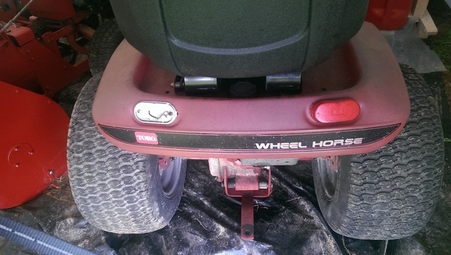

WNYPCRepair 1,924 #6 Posted April 8, 2016 Amazing how many of these I see with the left rear tail light broken, LOL Share this post Link to post Share on other sites

WVHillbilly520H 10,379 #15 Posted April 8, 2016 13 hours ago, WNYPCRepair said: Amazing how many of these I see with the left rear tail light broken, LOL I know what ya mean or is the right side... , Jeff 2 Share this post Link to post Share on other sites

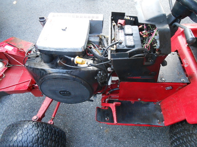

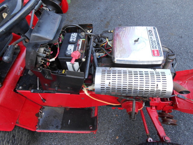

fireman 1,022 #17 Posted April 10, 2016 Well the weather was some what cooperative today so I headed out to see if I can get it fired up. Checked the oil and fuel tank. Oil was fine and fuel tank was empty which is a bonus (no stale gas)! I added fuel stabilizer and some fresh gas. Battery is shot (.5 volts and my charger read "Bad Battery") so I hooked up a jumper pack. The engine cranked and I saw fuel make it's way up to the fuel filter, but no fire. I sprayed the carb with some starting fluid and and cranked again and still nothing. I checked for spark and there was none. I can see that someone has monkeyed with the wiring a bit so instead of screwing around I went to the magical "Wheel Horse Demystification Guide" and printed out the section for the 1990 520H. Sometime this week I will go throw the wiring point to point and straighten out what ever the other guy messed with. In the mean time tomorrow I will pull off the hood and seat pan and get those hammered out. 2 Share this post Link to post Share on other sites

cheesegrader 436 #20 Posted April 10, 2016 (edited) I recognize that wiring! The PO has jumped a burnt connection at the 9-pin to get power to the starter. (and what an ugly splice! Yuck!) You are also missing a fuse (30 amp, I think) Edited April 10, 2016 by cheesegrader Share this post Link to post Share on other sites
Bow_Extreme 584 #21 Posted April 10, 2016 Here you go Fireman. I know the 520H wiring very well. I've probably redone 15 of them in the last 10 years. Share this post Link to post Share on other sites
fireman 1,022 #22 Posted April 10, 2016 48 minutes ago, Bow_Extreme said: Here you go Fireman. I know the 520H wiring very well. I've probably redone 15 of them in the last 10 years. Thanks for the tip! Share this post Link to post Share on other sites
Bow_Extreme 584 #23 Posted April 10, 2016 One more question. Did they really take a piece of extension cord and patch into the wiring harness? Share this post Link to post Share on other sites
roadapples 6,987 #24 Posted April 11, 2016 50 minutes ago, Bow_Extreme said: One more question. Did they really take a piece of extension cord and patch into the wiring harness? What`s your point ?.... 1 Share this post Link to post Share on other sites
fireman 1,022 #25 Posted April 11, 2016 (edited) Yup they sure did! Redneck engineering at it's best. They also used masking tape instead of electrical tape which I never use either. Shrink tubing is the only way to go to properly seal the connection and have a professional look. They funny part is shrink tubing is actually cheaper then a good roll of electrical tape! Edited April 11, 2016 by fireman 1 Share this post Link to post Share on other sites
