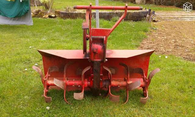

Bobie01 22 #1 Posted April 7, 2016 Hello. I'm a proud owner of a Raider 10. Now Somebody offered me a Tiller for 200 Euro. My questions are: Will it fit? The bracket for the axle is include What else is missing? What size of beld does i need to buy? What I have to check if I m buying it? I know that I have to fabricate e lever cable an the pulleys which are under the tractor. 3 Share this post Link to post Share on other sites

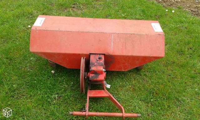

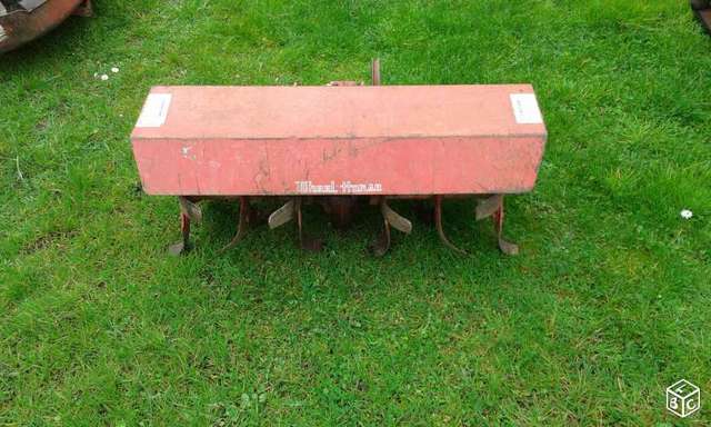

gwest_ca-(File Mod) 12,511 #2 Posted April 7, 2016 What is the model number and serial number on the aluminum tag hanging off the front in the 2nd photo? Garry 1 Share this post Link to post Share on other sites

gwest_ca-(File Mod) 12,511 #6 Posted April 7, 2016 A wild guess at what you need not knowing the model number of your tractor. Does it have 3 forward speeds or 6 forward speeds? The tines show little wear. Garry Share this post Link to post Share on other sites

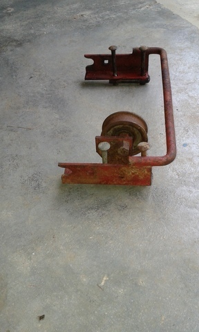

Bobie01 22 #9 Posted April 8, 2016 the owner send me a pic of this. Anyway A have to build something because the seller don't have the pully set anymore, he sold it whit the tractor. I have to convert it but that will be no problem 1 Share this post Link to post Share on other sites

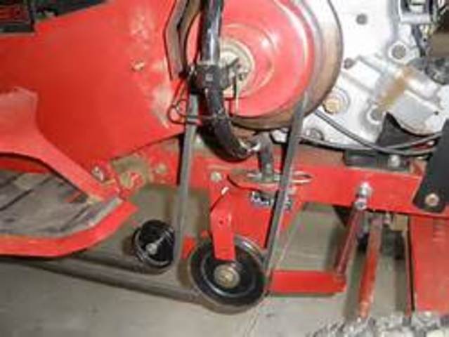

Racinbob 13,213 #10 Posted April 8, 2016 That's the bracket I had with my 1-1211 tiller. Forget the pulley set-up that mounted on front of the transmission (figures 2,3 & 4 in the 1-1211 manual). Get the idler assembly for the later style tiller (figures 3 & 3a in the 7-1251 manual or this pic). I have no clue what the belt length was so you'll have to determine that. I don't remember but I'm pretty sure it was different than the 1599 belt used on the 7-1251 tiller but maybe not. I liked this 'old/new' combo better that either the older style or the newer. I think I see the tag with the model # on it. Check it out. That tiller is in excellent condition. The tines look hardly used. 1 Share this post Link to post Share on other sites
