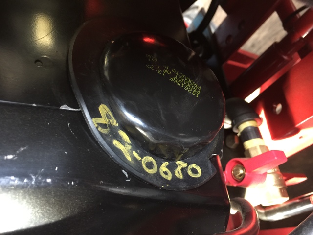

WVHillbilly520H 10,378 #28 Posted April 6, 2016 Yes there is "supposed" to be a rubber gasket that goes over the oil filter after its installed to seal it at/around the blower housing it has a cut out for the reinforced portion directly under the oil filter (sorry I can't post a picture till tomorrow) but sometimes it gets "lost" during oil changes and/or it deteriorates over time but either way yes it should be installed,Jeff. Share this post Link to post Share on other sites
Phatboy 566 #29 Posted April 6, 2016 3 minutes ago, WVHillbilly520H said: Yes there is "supposed" to be a rubber gasket that goes over the oil filter after its installed to seal it at/around the blower housing it has a cut out for the reinforced portion directly under the oil filter (sorry I can't post a picture till tomorrow) but sometimes it gets "lost" during oil changes and/or it deteriorates over time but either way yes it should be installed,Jeff. Im goong to look now of i dont habe one im going directly to my dealer and getting one,, Share this post Link to post Share on other sites

Phatboy 566 #32 Posted April 6, 2016 Had one on there bit it was glied to shroud and kinda hard so i went to dealer and bought a new one !! Share this post Link to post Share on other sites

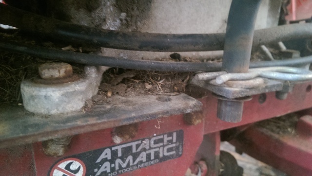

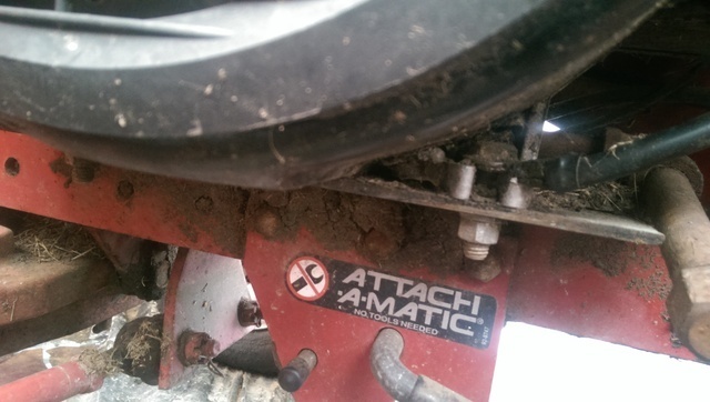

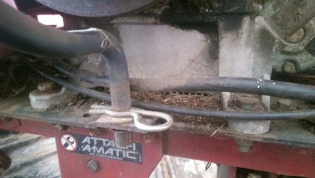

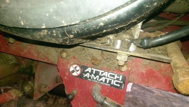

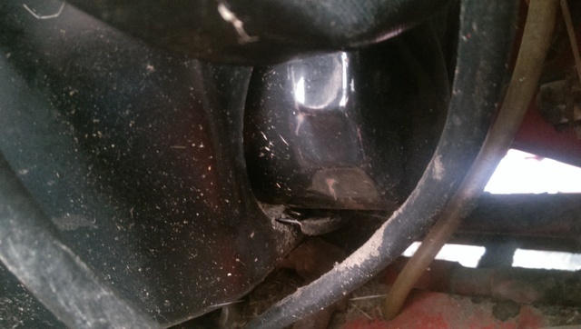

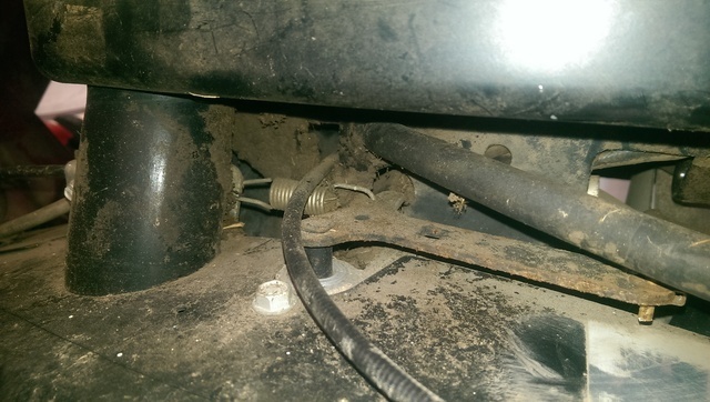

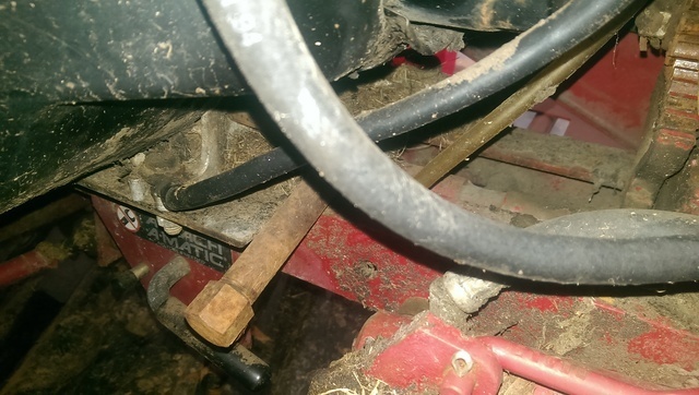

WVHillbilly520H 10,378 #33 Posted April 7, 2016 Well this how your 520 or other Onan powered WH should NEVER look...like the one I just picked up with 236 hrs on it and all the gunk in that time,Jeff. Share this post Link to post Share on other sites
