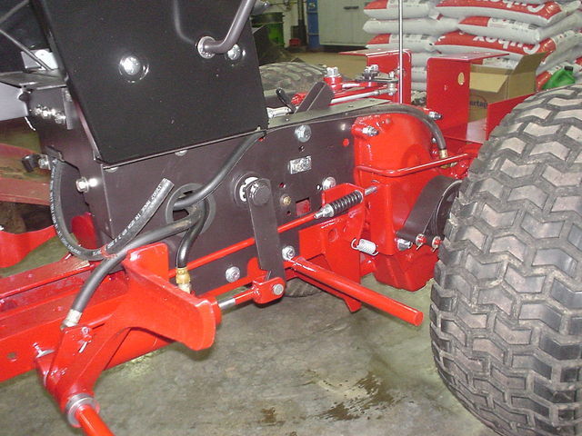

DougsTractorShed 86 #1 Posted April 4, 2016 (edited) Hello folks. Longtime lurker but finally get to make my first post. After quite awhile of looking around I found the perfect tractor and deal on my local Craigslist last week. It was a 312-H in good shape that was being sold by the original owner. When I showed up to check it out I was ecstatic and bought it on the spot. This tractor only has 600 hours on it and came with a plow (only used a handful of times), 37" mower deck, wheel weights, chains, and bagger. Also had several spare belts, blades and all the original manuals/paperwork. Ran the serial numbers and its a 1990. I got it home, gave it a good once over and shined it up. The tractor cuts great and runs like a dream. My dad owns a 315-8 so its cool to have close to matching tractors, and I love the sound of that Kohler stroke. Anywho, outside of adjusting the mower the only thing I've found that needs some TLC is the parking brake. It currently does not engage and at the recommendation of some people from the Wheel Horse Junkies FB group I had the rear left off and found the adjustment bolt. Only problem is the bolt was just sitting there loose with nothing to screw it into. It would appear the assembly the adjustment bolt goes into is sheared off. Is there a good exploded parts view of a 300 series so I can figure out what I need? I was looking around on here but couldn't find one. Thanks! Edited April 4, 2016 by thisdougsforu 7 Share this post Link to post Share on other sites

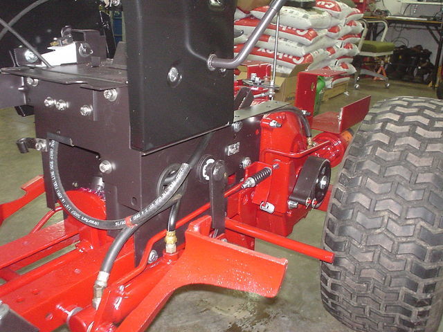

cleat 9,017 #4 Posted April 4, 2016 Here are a couple of pics of my 520HC parking brake if that helps at all. 3 Share this post Link to post Share on other sites

DougsTractorShed 86 #6 Posted April 4, 2016 (edited) Thanks for the welcome everyone! And cleat, that picture really does say a thousand words. Looks like all I'm missing a nut & washer, which I've highlighted with a green arrow. That's just a standard 9/16 nut correct? Or does it have a flange? I can't really see from the picture. http://i68.photobucket.com/albums/i22/thisdougsforu/tractor-parking-brake_zpsyeumykkc.jpg[/IMG]] Edited April 4, 2016 by thisdougsforu 2 Share this post Link to post Share on other sites
cleat 9,017 #7 Posted April 4, 2016 Yes, just a standard 3/8 NC nyloc locking nut. 2 Share this post Link to post Share on other sites
gwest_ca-(File Mod) 12,346 #8 Posted April 4, 2016 Here is the parts page https://www.partstree.com/parts/toro/mowers-lawn-garden-tractor/31-12ke01-312-h-toro-312-h-garden-tractor-1990/clutch-brake-and-speed-control-linkage-312-h-416-h_2/ Garry 2 Share this post Link to post Share on other sites
DougsTractorShed 86 #9 Posted April 4, 2016 You guys are awesome! Had a 3/8 nylon nut and washer in the hardware bins at work so I'll put it on and hopefully I'm good to go. 2 Share this post Link to post Share on other sites
cleat 9,017 #10 Posted April 4, 2016 You were lucky to lose the nut and washer but not the spring. Here are a couple more links. http://www.mowerpartpros.com/OEMpartfinder.htm#/Toro_Consumer/31-12KE01,_312-H_Garden_Tractor,_1990/CLUTCH,_BRAKE_AND_SPEED_CONTROL_LINKAGE-312-H_&_416-H/31-12KE01-2527-1990/810726R1-26R10016-0006 http://www.mowerpartpros.com/OEMpartfinder.htm#/Toro_Consumer/31-12KE01,_312-H_Garden_Tractor,_1990/CLUTCH,_BRAKE_AND_SPEED_CONTROL_LINKAGE-312-H_&_416-H/31-12KE01-2527-1990/810726R1-26R10018-0007 1 Share this post Link to post Share on other sites

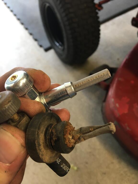

DougsTractorShed 86 #21 Posted April 5, 2022 Hey folks. funny I made this thread 6 years ago. I've put a couple hundred more hours on the 312 (and added 3 more Horses to the stable!) and it's time for real service on it, as for the last few seasons it's been starting tough. If it sits for a week, it's tough to fire without starting fluid and even then sometimes needs to be started a few times with it to actually run. Once it's running, it was fine. Until end of last season. A few times when cutting the engine would idle down and it would die. It would refire after sitting a bit, using more fluid. Also of note is that the tractor had been backfiring sometimes when shut down (I wouldn't be shutting it off from high throttle, either, it would be from low idle). Anyways, I'm going to be getting it out of storage for service before the cutting season. I'm assuming my problem is fuel delivery and it needs the carb cleaned. A good friend also recommended going through the fuel line as well and probably replacing it. Outside of the obvious like a new plug, any other ideas what to look for here? 1 Share this post Link to post Share on other sites
Sparky-(Admin) 25,934 #22 Posted April 5, 2022 Replace the fuel shutoff and grommet that’s under the fuel tank, install all new fuel lines and add in (if you don’t already have one) an in-line fuel filter. 1 Share this post Link to post Share on other sites
Sparky-(Admin) 25,934 #23 Posted April 5, 2022 Here’s the fuel shutoff/filter that was in the tank of a 312-8 I had in my garage a few years ago. Hard starting tractor and would occasionally cut off like it was starving for fuel…and it was!! 1 Share this post Link to post Share on other sites
DougsTractorShed 86 #24 Posted April 5, 2022 Oh man, thanks for that. Before I bought the tractor in 2016 from the original owner, i believe he did let it set for a season and I bet i'll find something like that. Did you order a new one from a specific place or can i find them new still via Toro? 1 Share this post Link to post Share on other sites
Sparky-(Admin) 25,934 #25 Posted April 5, 2022 1 hour ago, thisdougsforu said: Did you order a new one from a specific place or can i find them new still via Toro? https://www.amazon.com/Warehouse-WHEELHORSE-SHUT-OFF-GROMMET-HF983-1754353261/dp/B01L13M2BO Not sure where I bought mine, I have a few tractors so I try to keep one in-stock at all times. 2 Share this post Link to post Share on other sites
