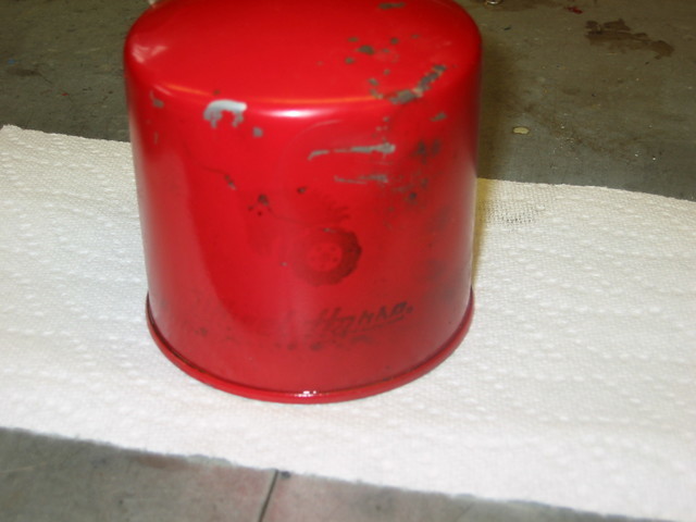

pfrederi 20,678 #7 Posted April 5, 2016 The Toro WH filters at my dealer say Toro above Wheel Horse and the filters are black. What I was asking about was when did they stop using red filters that had no Toro markings. i am thinking the Red filter only saying Wheel Horse (slanted printing) has been on the tractor a long time. Toro bought Wheel horse in 1986 30 years ago 3 Share this post Link to post Share on other sites

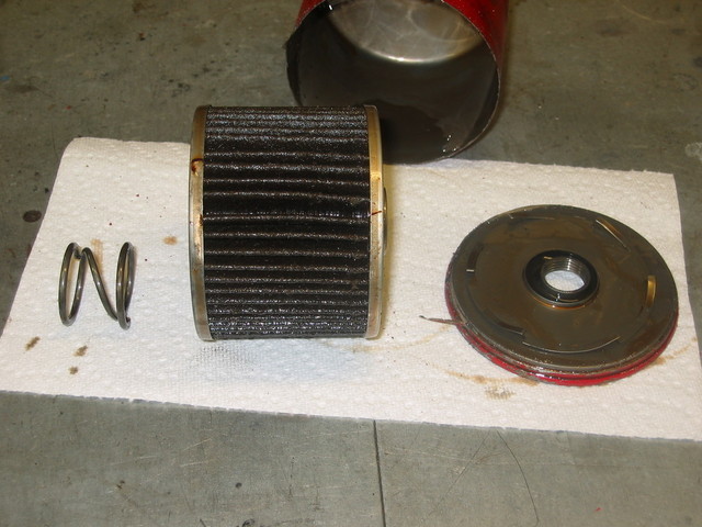

squonk 46,893 #8 Posted April 5, 2016 Paul, have you taken the filter off yet? If you have it, could you cut it open and post pics? I'm curious to see if they made them better back then. The black one I cut open reminded me of a junk Fram 1 Share this post Link to post Share on other sites
pfrederi 20,678 #9 Posted April 5, 2016 any particular way to cut it??? Share this post Link to post Share on other sites

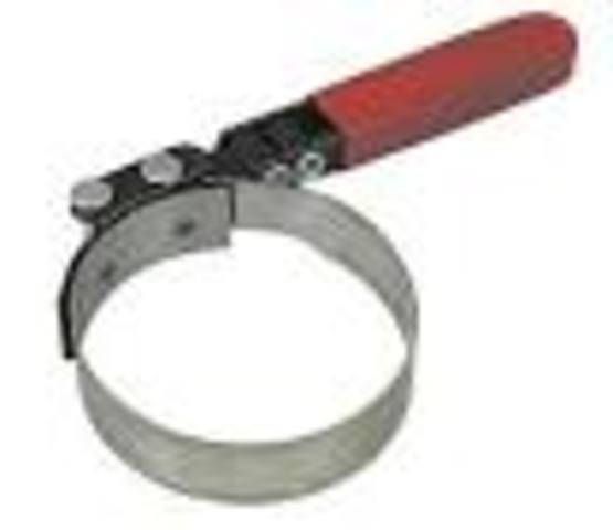

WHX?? 56,853 #10 Posted April 5, 2016 NO don't listen Mike.... That would look cool sitting on the antique shelf in the barn.... 'pecially if its got the logo on it!!! 7 hours ago, shallowwatersailor said: there is nothing to grip. Not even with one of these John? 1 Share this post Link to post Share on other sites
squonk 46,893 #11 Posted April 5, 2016 Cut it around the base near the lip. Just cut thru the shell to preserve the innards for inspection. see my pics Share this post Link to post Share on other sites

shallowwatersailor 3,221 #13 Posted April 6, 2016 4 hours ago, WHX61/3 said: NO don't listen Mike.... That would look cool sitting on the antique shelf in the barn.... 'pecially if its got the logo on it!!! Not even with one of these John? On the last one I ended up bending the handle where it swivels on a brand new strap wrench. The 3 filters must have been put on dry as there isn't enough heat like an engine to "bake" them on. On a Classic Wheel Horse I usually take off the left rear wheel for better leverage, but on a 5xi it is underneath which doesn't leave much room to pivot the wrench. 1 Share this post Link to post Share on other sites

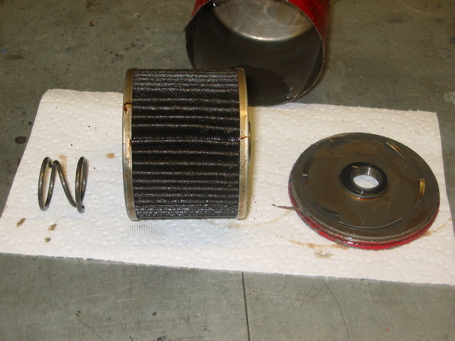

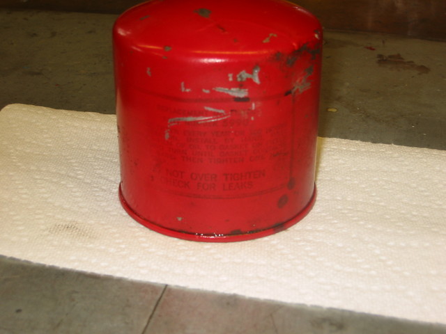

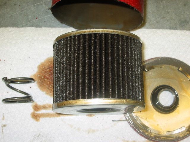

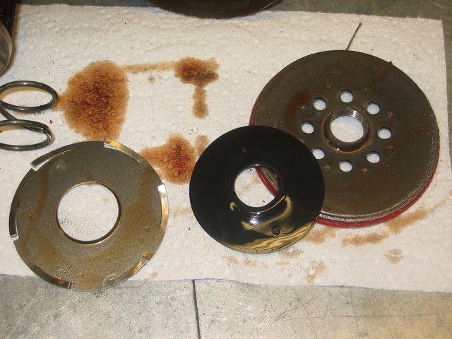

pfrederi 20,678 #14 Posted April 6, 2016 Pictures of an old (pre-Toro) filter. 2 Share this post Link to post Share on other sites

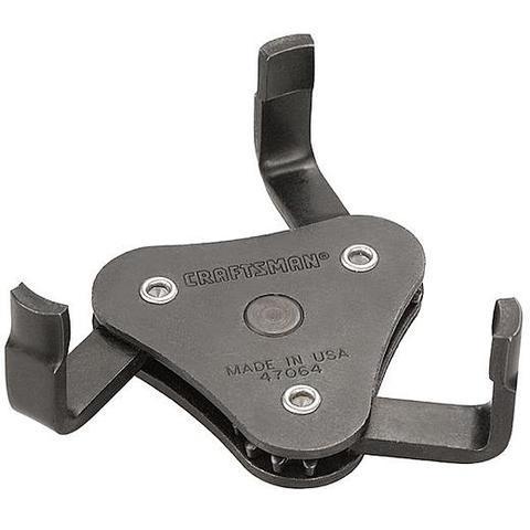

TDF5G 2,074 #15 Posted April 6, 2016 20 hours ago, WHX61/3 said: NO don't listen Mike.... That would look cool sitting on the antique shelf in the barn.... 'pecially if its got the logo on it!!! Not even with one of these John? Share this post Link to post Share on other sites
squonk 46,893 #16 Posted April 6, 2016 That's one nasty filter for having ATF run thru it. They made them better in the old days. That spring in the newer filter has been replaced by a bent piece of tin and there's less pleats nowadays also. Share this post Link to post Share on other sites
