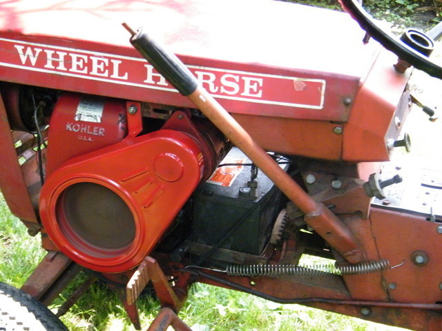

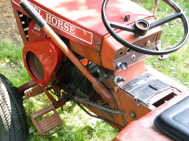

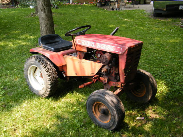

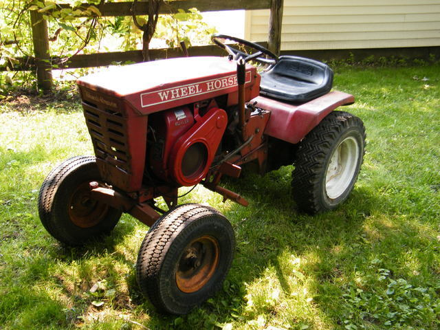

Mike_W 51 #1 Posted April 3, 2016 Bought yesterday, motor runs very good. Pics, then some questions. SN from dataplate 92904 12 Share this post Link to post Share on other sites
Tankman 3,528 #2 Posted April 3, 2016 Looks great! How are you going to use the Horse? Share this post Link to post Share on other sites
Mike_W 51 #3 Posted April 3, 2016 I've not seen the sheetmetal foot rest on other 876's I've seen photos of, are they aftermarket? Also, my throttle creeps closed, is there a method so it's static where you pull it to? 2 Share this post Link to post Share on other sites

stevasaurus 23,658 #7 Posted April 3, 2016 I think someone has done some fabrication...like the running boards. My 876 does not have the running boards and has a control by the left rear tire to engage the hydro. Yours seems to have some hydraulics mounted on the left side. Your throttle would have an arrow showing how to lock it if that is what you have. I happen to have a "T" throttle on mine...it is not supposed to be there to be correct. 4 Share this post Link to post Share on other sites
Mike_W 51 #8 Posted April 3, 2016 The hydraulic lift levers were perhaps added, I have the manual for "Wheel horse Hydraulic Unit HY-6" and it shows the removal of the lift lever and installation of the hydraulic levers. I see a twist lock throttle unit on ebay for a Ranger, I might pick that up. 2 Share this post Link to post Share on other sites

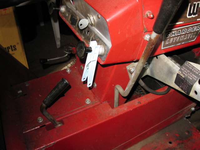

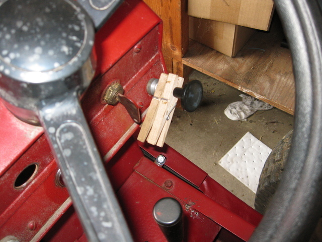

pfrederi 20,146 #20 Posted April 3, 2016 I am too cheap to buy new Throttle cables...That rarely seem to work. One equals fast idle 2 Full throttle. They come in various thicknesses if you want to have different speeds. also use them on the hand throttle of my M37 11 Share this post Link to post Share on other sites
Mike_W 51 #21 Posted April 4, 2016 LOL, good to know my cable isn't the only one with creep. I'll try the cable kink and if not I'll add a lever like Stevasaurus did. Share this post Link to post Share on other sites
857 horse 2,588 #22 Posted April 4, 2016 I juss wanna know about Squonk's Banana dancer,,,,,,and i think the cloths line clips look like they work great....loose one?? cheep to replace. !!!! 2 Share this post Link to post Share on other sites
briankd 833 #23 Posted April 4, 2016 guess im not the only one that had vise grip clamped on throttle cable to keep it stay put. small vise grips work really well 2 Share this post Link to post Share on other sites
