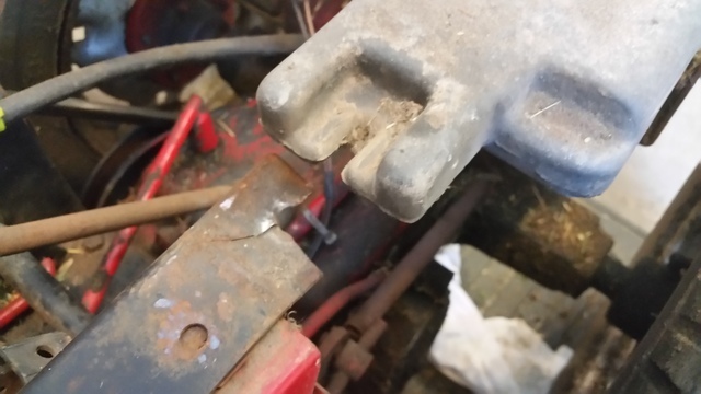

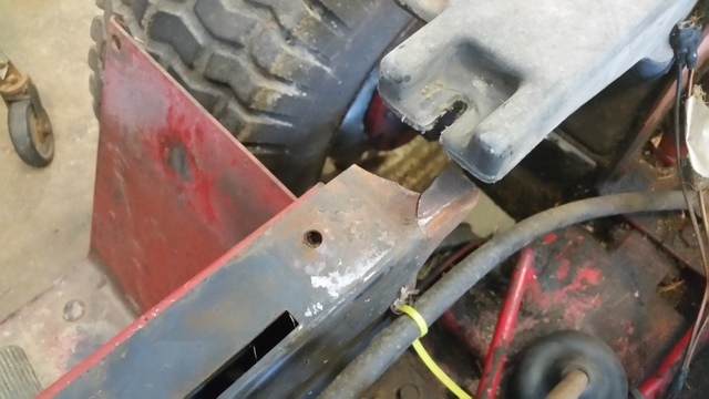

USHorse 41 #1 Posted April 3, 2016 the ends on each side of the hood stand where the seat support bracket bolts to are cracked and metal broken off. Can a good welder fab new pieces and weld in? Wish I took the time to investigate last fall after mowing season as to remove hood stand will take some time. Removing hood stand requires steering wheel removal too? 1 Share this post Link to post Share on other sites

c-series don 12,108 #4 Posted April 3, 2016 Removing the hood stand is a lot of work. I just fixed mine in place. After removing the gas tank and fuel line I used a cut off wheel on a die grinder to square up the crack. Then cut and fit a piece of angle iron and welded it in place. As far a the holes go I have not drilled them yet, I'm going to put the gas tank and fender support back in place to determine where they go. Apparently this is a common problem with this series of tractors. Someone here said there is a factory support plate or something like that you can add, but I have never seen such a thing. If there is I would really like to see it. Share this post Link to post Share on other sites
daveoman1966 3,884 #5 Posted April 3, 2016 (edited) I had this issue on two of my horses. Used a 2 x 2 (approx.) 6" angle iron of approx. same thickness and fit it between the side panel and break-away section. Clamped in place, drill holes for original locations, and leave a little bit too long...cut off as your see fit. Fit a big washer in the square break-=away area to fill in the 'gap', then bolt down the gas tank and rethread the panel bolt going down thru.. presto... fixed. Edited April 3, 2016 by daveoman1966 Share this post Link to post Share on other sites
USHorse 41 #6 Posted April 3, 2016 15 minutes ago, daveoman1966 said: I had this issue on two of my horses. Used a 2 x 2 (approx.) 6" angle iron of approx. same thickness and fit it between the side panel and break-away section. Clamped in place, drill holes for original locations, and leave a little bit too long...cut off as your see fit. Fit a big washer in the square break-=away area to fill in the 'gap', then bolt down the gas tank and rethread the panel bolt going down thru.. presto... fixed. I am reading your post that your repair was with no welding? That would save me the hassle of tearing down and taking to a shop. Share this post Link to post Share on other sites
Stigian 1,235 #7 Posted April 3, 2016 I've come across this issue on a few WH's, as long as you remove the gas tank and disconnect the battery they are easy to weld up in situ.. 3 Share this post Link to post Share on other sites
Phatboy 566 #8 Posted April 3, 2016 Mine cracked on my 310 and i just used a thin piece of thin angle and welded ( my sister n law) union pipe fitter ,, welded it into place ,,lol and lasted 7 years so far.. 3 Share this post Link to post Share on other sites
USHorse 41 #9 Posted April 3, 2016 Thank u all. Sounds like some welding is in order. As I stare closer at my tranny now that the seat is off, looks like axle seals are not doing their job. Like layers of an onion...LOL Share this post Link to post Share on other sites
