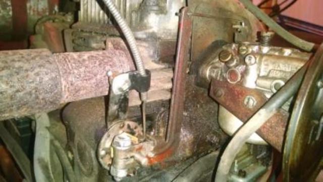

Achto 32,920 #3 Posted April 3, 2016 In this pic you can see how the previous owner had the cable running directly to the carburetor. Well kinda,not the best pic. A lot of other bad stuff going on in this pic too. I moved the cable to this location.The cable only has about 1/4" of travel. Is this correct? My 1076 has about 3/4" of travel, this is why I'm questioning my placement of the cable on this tractor. Share this post Link to post Share on other sites
wallfish 20,733 #4 Posted April 3, 2016 No matter where you place the conduit holder, the amount of travel is determined by the rotation of the disc. At one point there was a small arm which was welded to the disc which you could attach the cable to. If it's not there then you can add one to move the wire connection to the disc farther away from the center, which will give you more travel of the throttle. I have tractors like yours with minimal throttle travel but since I run them full throttle or idle and not much in between, it doesn't really bother me. Share this post Link to post Share on other sites
