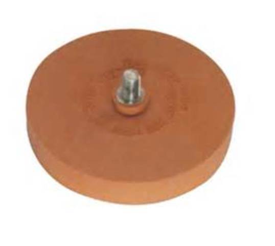

squonk 44,891 #4 Posted April 1, 2016 Rubber wheel pinstripe remover. 2 Share this post Link to post Share on other sites

squonk 44,891 #16 Posted April 2, 2016 If you use one of these wheels on a drill the decal will come right off with out marring the paint at all. Acts like a big eraser Randy. Living along 89 makes anyone a savage! 1 Share this post Link to post Share on other sites

Racinbob 12,432 #20 Posted April 2, 2016 (edited) I never go behind the metal mainly because you usually can't on vehicles unless you want to tear them apart. I also don't like getting the metal that hot when all you need to do is release the adhesive but obviously it doesn't hurt anything. Once you get the edge started it will pull right off cleanly following the the glue contact edge with the gun. I hadn't heard of the wheel Mike mentioned. This video covers that as well. Pretty cool and this guy likes it better than heat. Edited April 2, 2016 by Racinbob Share this post Link to post Share on other sites

Zeek 2,298 #22 Posted April 5, 2016 On 4/2/2016 at 8:37 PM, DennisThornton said: I usually used heat gun judiciously to soften and weaken the adhesive and just pull it off a few heated inches at a time. Too little heat and the decal won't release or just breaks as you pull too hard but too hot and the decal stretches too much. Focus the heat on the metal and remaining decal and none on what you are pulling on. Adhesive remover for what remains. I usually do this with good success. However I'm curious about Squonk's idea . . . On 4/2/2016 at 11:07 AM, squonk said: If you use one of these wheels on a drill the decal will come right off with out marring the paint at all. Acts like a big eraser Randy. Living along 89 makes anyone a savage! I might try this, where did you get it and long does it hold up on some of the really old decals? Share this post Link to post Share on other sites
squonk 44,891 #23 Posted April 5, 2016 I got mine from Napa. It depends on what the decal is made of and what kind of adhesive was used. I'm sure it won't work on everything, but it wont harm the paint. I did an old decal and the decal kind of disintegrated. I did have to use some chemical on the old glue. They last quite a while. Too much pressure and it will wear faster along with heating up the metal too much Share this post Link to post Share on other sites
