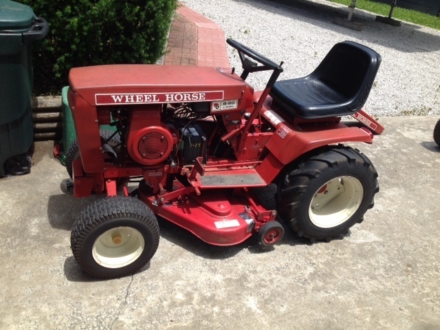

TDF5G 2,073 #31 Posted March 31, 2016 (edited) I bought a new pair of AGs for my B-80 twenty years ago to get better traction for mowing the hills in my yard. Carlisle 23X8.50-12 2 ply. Still using them. Edited March 31, 2016 by TDF5G 2 Share this post Link to post Share on other sites

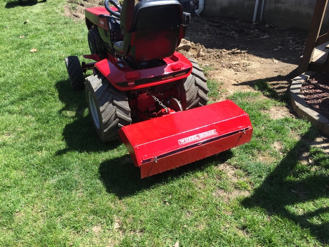

Phatboy 566 #32 Posted April 17, 2016 Carslile true power on back and carslile super lugs on front,,, 4 Share this post Link to post Share on other sites

Phatboy 566 #38 Posted April 18, 2016 On April 17, 2016 at 7:48 AM, c-series don said: Ok so which is it tru-power or super lugs? Tru-Power on back and super lug on front ,, Carlsile doesnt make a true power for the front ,, but the super lugs match the true power perfectly ,,, and they ride smooth also ,, at least i think so ,, love them tires on my 520 2 Share this post Link to post Share on other sites

TDF5G 2,073 #42 Posted May 19, 2016 The AG tires solved my problem for getting around on the hilly areas of my yard when mowing. I used the original turfs for a couple of years, then put on the the AGs. See my pic of the B-80 in post above. A couple of things I've learned is that if you spin out, the turf tires will leave a bigger bare spot in the yard than the AGS will. And when you spin the turfs you're done, you have to go downhill. If the AGs spin, you still have a chance to get traction below the sod. You learn as you go. Like shifting body weight over the rear tire that needs it. After mowing with the same for 22 years I know when to shift my weight before she spins the tire. Me and a buddy used to cut firewood and sell it when we were in high school. We used his Dad's '68 to haul the wood up out of the hollers of his grandpa's junkyard. The had original turfs and chains. No problem with traction at all unless we hit deep mud, which we learned to avoid. But I wouldn't recommend chains for mowing a nice lawn. 1 Share this post Link to post Share on other sites
