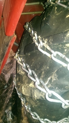

RedRanger 1,470 #2 Posted March 29, 2016 (edited) I'd agree tires are not made like they use to be and agree that ags don't wear real well, but I have to wonder what kind of base they're being driven on if they wear down real fast? After all, ags are designed to be run in the dirt. I'd think if they didn't see pavement or concrete, they'd wear pretty good? Soft rubber helps with traction, and traction/digging is what ags are for. Just guessing here, as I'm running turfs and ATV tires on my workers. The winter chain thing is a whole nother discussion. More about surface contact than rubber hardness I believe. Just like shoes, all tires have a purpose. Just like there is no perfect shoe for every use, there is also no perfect tire for all uses. Ags Turf ATV Smooth Ribbed Diamond Even variations within each of the above. They all have a different purpose. Now just think if like shoes, you had a closet full of tires, and needed to change those tires each time you used your tractor. Gonna till the garden today...put on the ags. Gonna mow today...put on the turfs. Gonna go for a trail ride today...put on the ATV tires. Gonna head down to the asphalt races today...put on the slicks. Gonna lounge around the garage today... Edited March 29, 2016 by RedRanger 8 Share this post Link to post Share on other sites

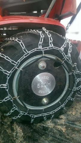

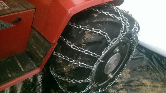

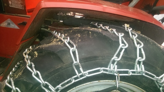

WVHillbilly520H 10,379 #3 Posted March 29, 2016 I have had these AG bar type tires on my 520H for approximately 8-9 yrs now and I bought them used on top of that...they spring till the garden, did 1/4 mile long dirt/gravel driveway repairs, mowing all summer and winter snow removal (the 1/4 mile dirt driveway) and now the asphalt drive here and dragging felled trees for firewood...still about the same as when I bought them...and they aren't Carlisle either,Jeff. 5 Share this post Link to post Share on other sites

WVHillbilly520H 10,379 #9 Posted March 29, 2016 Weather cracked when I bought them used it's not a show rig it's a work horse...so let's go the orginal post about wasting money on AG tires...so for $50/pr and 8-9 yrs later of my use and they're still holding air and 5 gallons of fluid and rolling my tractor around...there was no waste of money...and it's not my vehicle driving up and down the interstate @ 70 mph + everyday...why worry over weather cracking they make tubes if needed for my 4-7 mph jaunts up the driveway garden and yard...and when the wife's high $ Michelin tires weather cracked after 2 years let's talk about a waste of money...Jeff 5 Share this post Link to post Share on other sites

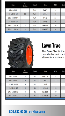

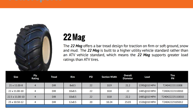

WVHillbilly520H 10,379 #11 Posted March 29, 2016 Might I add this while researching for new tires for in the future...a company called OTR...ATV/UTV style compound on the 22 Mag... 5 Share this post Link to post Share on other sites

tractorhogg 667 #13 Posted March 29, 2016 (edited) 2 hours ago, WVHillbilly520H said: Might I add this while researching for new tires for in the future...a company called OTR...ATV/UTV style compound on the 22 Mag... Well the 22 mag has very little tread height, it wouldn't perform well in loose soil where you need an AG, again "4 Ply Rating", that is not a 4 ply tire. The Lawn Trac just has a modified AG tread, that again, has no lug height, that tire won't perform in many garden tractor condition. Those conditions do not include use on dry grass without hills, flat asphalt or pavement. 17 minutes ago, slammer302 said: I believe it comes down too. Are you buying the right tire for your needs? Are you buying a cheap tire and expecting the performance and durability of a high quality tire. If so you may be let down. I do believe the cheap bar style tires do fill a niche in the GT world. Yep they sure do, like I said in my original post, if you don't need an AG tire, but want your machine to look cool those work fine 2 hours ago, neil said: I bought some duro ags a couple of years ago for my Raider 10 , & I guess I must have driven about 1 mile on them so far and now they have cracked quite badly , I think I will consider trying out some ATV tires next time round . Duro makes many different levels or quality of tire, the one they make that I did find good was one they designed for ATVs that were 6 ply rated, and were rated as use at highway speeds. The Duro Frontier 2 hours ago, WVHillbilly520H said: Weather cracked when I bought them used it's not a show rig it's a work horse...so let's go the orginal post about wasting money on AG tires...so for $50/pr and 8-9 yrs later of my use and they're still holding air and 5 gallons of fluid and rolling my tractor around...there was no waste of money...and it's not my vehicle driving up and down the interstate @ 70 mph + everyday...why worry over weather cracking they make tubes if needed for my 4-7 mph jaunts up the driveway garden and yard...and when the wife's high $ Michelin tires weather cracked after 2 years let's talk about a waste of money...Jeff Why I never buy Michelin's any more, they went to making junk tires, might as well use Firestone. Well then you did good if you bought them used!!!! but you left out what you paid for them. 3 hours ago, C-101plowerpower said: i've got bkt tr315's on mine, haven't had them on that long(only last fall). they are quite hard rubber. we also run bkt's on our bigger tractors one of which gets used mostly for transport and on there they hold up really well. most of the oldtimer tractors over here run bkt's because they're pretty damn good for the money I used BKT on My International 424 and was very impressed with them, the trenchers are okay, but like I said the lugs are really thin and close together, if they were a little thicker, and taller, they would be better, but they have not worn hardly at all in 4 years Edited March 29, 2016 by tractorhogg 1 Share this post Link to post Share on other sites
tractorhogg 667 #14 Posted March 29, 2016 5 hours ago, RedRanger said: I'd agree tires are not made like they use to be and agree that ags don't wear real well, but I have to wonder what kind of base they're being driven on if they wear down real fast? After all, ags are designed to be run in the dirt. I'd think if they didn't see pavement or concrete, they'd wear pretty good? Soft rubber helps with traction, and traction/digging is what ags are for. Just guessing here, as I'm running turfs and ATV tires on my workers. The winter chain thing is a whole nother discussion. More about surface contact than rubber hardness I believe. Just like shoes, all tires have a purpose. Just like there is no perfect shoe for every use, there is also no perfect tire for all uses. Ags Turf ATV Smooth Ribbed Diamond Even variations within each of the above. They all have a different purpose. Now just think if like shoes, you had a closet full of tires, and needed to change those tires each time you used your tractor. Gonna till the garden today...put on the ags. Gonna mow today...put on the turfs. Gonna go for a trail ride today...put on the ATV tires. Gonna head down to the asphalt races today...put on the slicks. Gonna lounge around the garage today... Nah, don't change tires, just buy more tractors 2 Share this post Link to post Share on other sites

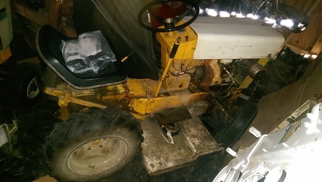

RedRanger 1,470 #20 Posted March 29, 2016 Here's one just to mess with everyone. 7 Share this post Link to post Share on other sites

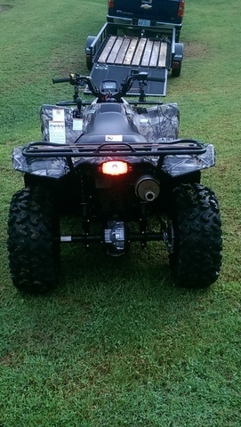

WVHillbilly520H 10,379 #21 Posted March 29, 2016 Or my personal ATV and the tires I chose for it... Share this post Link to post Share on other sites

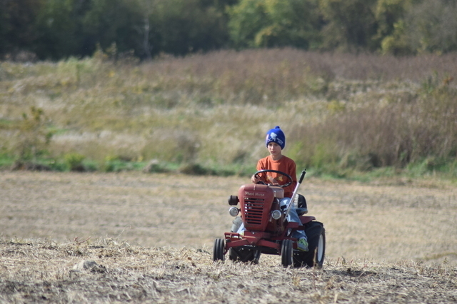

Terry M-(Moderator) 2,329 #24 Posted March 29, 2016 The most experience I have with Ag tires are the ones on my son's 67 Lawn Ranger. I KNOW, Its not a real work machine, but he's rode on them for hours at different shows, rode on them all day last fall at a local plowing event here in Minnesota and even got it stuck...and last spring he literally put a few miles on them riding on the neighborhood sidewalks.. Still look like new with those "Nubbies" still attatched. Not arguing, just saying 7 Share this post Link to post Share on other sites
