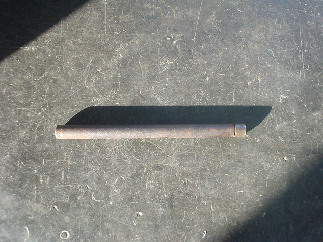

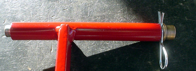

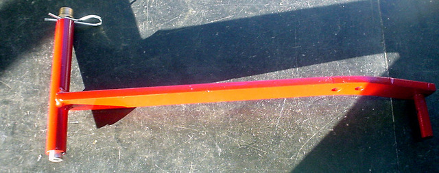

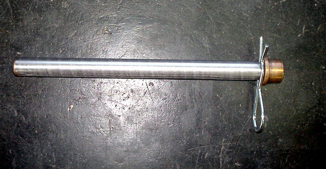

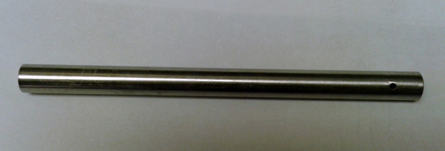

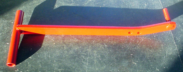

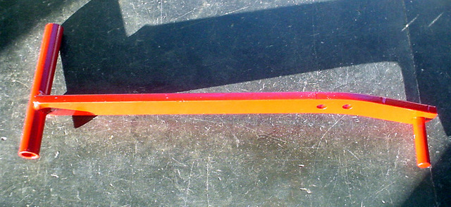

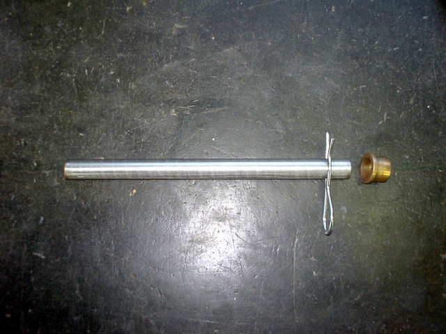

cleat 8,902 #1 Posted March 29, 2016 I have the heavy duty lift link in all of my 520's and this pin always seems to be worn. You can buy them new from Toro but I am cheap so I made my own. I can't duplicate the e-clip so I simply drill a hole and use a hairpin clip to secure it. Actually works better because now removing this lift bar is tool free. This is the original pin worn on the ends and a loose sloppy fit. This is the new pin and the plans to make your own. I used Stainless steel because that is what I had. Wheel horse heavy duty lift bar pin dimensions.pdf 7 Share this post Link to post Share on other sites

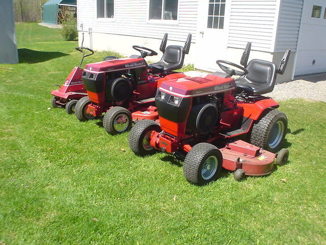

MalMac 1,336 #2 Posted March 29, 2016 Just curious, do you use a 60" deck on your 520? 1 Share this post Link to post Share on other sites
cleat 8,902 #3 Posted March 29, 2016 Yes, I have a 60" deck on one of my 520's I know that using the HD lift bar on smaller decks is likely not needed but it is what they came with. 2 Share this post Link to post Share on other sites
MalMac 1,336 #4 Posted March 29, 2016 I can always tell when a 520 has had a 60" deck used on it. Those decks are nice, mow well and are built like a battleship. It's they put more wear and tear on a tractor and are just plain hard on them. Share this post Link to post Share on other sites
