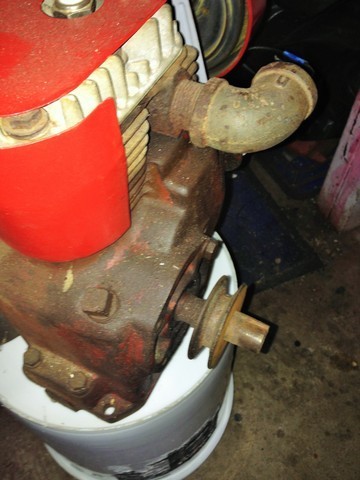

Lane Ranger 12,167 #6 Posted March 28, 2016 (edited) Yes I had my 3/4 tap on a non-tapped Kohler K 91 done for $20 one morning at the local machine shop. I had priced a new 3/4 NPT pipe tap and was surprised how much a new one was. Later found one at a swap meet that was $ 8.oo ! Edited March 28, 2016 by Lane Ranger 1 Share this post Link to post Share on other sites

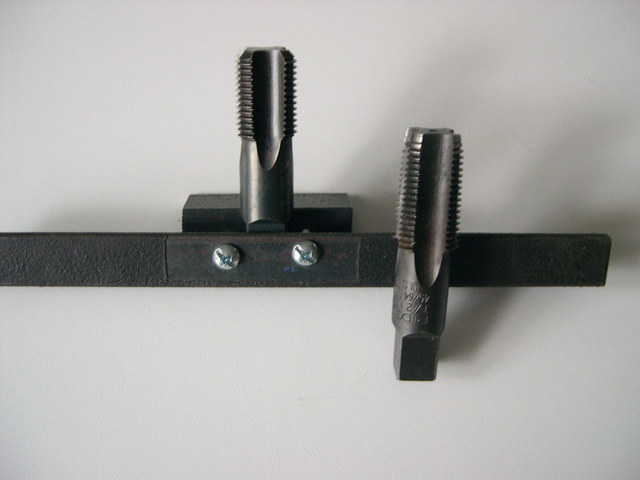

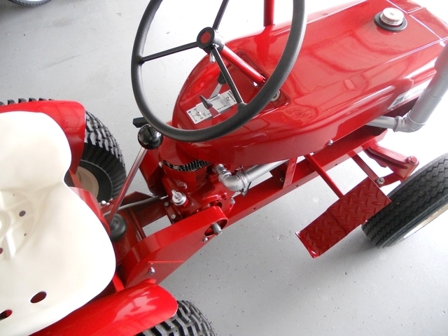

Racinbob 13,290 #7 Posted March 28, 2016 (edited) No need to go 3/4" That's really pushing things as far as the amount of meat there is. The hole is actually a few thousands over for a 1/2" NPT tap. I used a taper tap (on the right) and followed up with a bottoming tap (in the makeshift tap wrench). That allowed more usable threads but I could have gotten by just fine without it. Stuff an oil soaked rag in the hole and have at it. It taps pretty easily. Just make sure you don't leave any chips behind. To extent the pipe the proper distance to clear the hood stand I used a 1 1/2" long nipple and a 1/2"x3/4" street elbow. Both styles of taps are readily available for under $10 shipped on Ebay. The reduction in pipe size for that short distance is insignificant. Edited March 28, 2016 by Racinbob 7 Share this post Link to post Share on other sites
