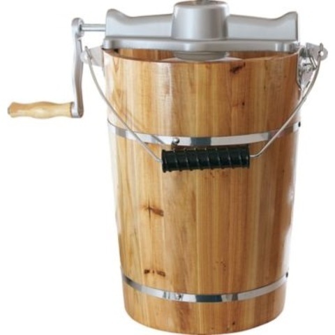

wallfish 20,572 #4 Posted March 28, 2016 (edited) Get this and a gearbox to slow down the spin and get a churn'n! Or use a WH generator to power the electric motor I'll stop by and see ya for my free ice-cream! http://www.cabelas.com/product/AmeriHome-Ice-Cream-Maker/1621810.uts?productVariantId=3532287&srccode=cii_328768002&cpncode=37-173720005-2&WT.tsrc=PPC&WT.mc_id=BingPLA&WT.z_mc_id1=03717127&rid=20 Edited March 28, 2016 by wallfish 2 Share this post Link to post Share on other sites

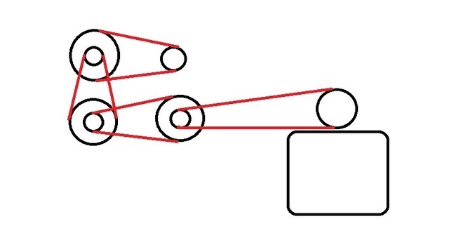

c-series don 12,420 #15 Posted March 29, 2016 Ok so from what I can gather I have to get some big pulleys so I can turn this thing slow enough. I do remember the guy at the show running his tractor just above an idle, then as the load increased it would gradually slow the engine till it stalled. Then the ice cream was ready. At least that's how I think it was done,it's been a few years. I can't be the only one here that remembers this, can I? Maybe it was all a dream. Like having a 420LSE with your name on the hood plate!! 1 Share this post Link to post Share on other sites
953 nut 69,066 #16 Posted March 29, 2016 9 hours ago, c-series don said: some big pulleys so I can turn this thing slow enough If you have an extra transmission sitting around you could get a selection of speeds from it. 2 Share this post Link to post Share on other sites
wallfish 20,572 #17 Posted March 29, 2016 19 hours ago, c-series don said: Ok so from what I can gather I have to get some big pulleys so I can turn this thing slow enough. You don't necessarily need BIG pulleys. You can use multiple pulleys to multiple shafts to achieve the reduction. Chain and sprockets can be done in a smaller package. You can find calculators on the net to figure out sizes to match the RPM you need 2 Share this post Link to post Share on other sites
