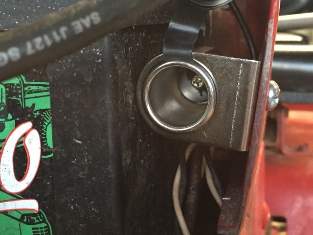

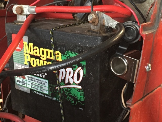

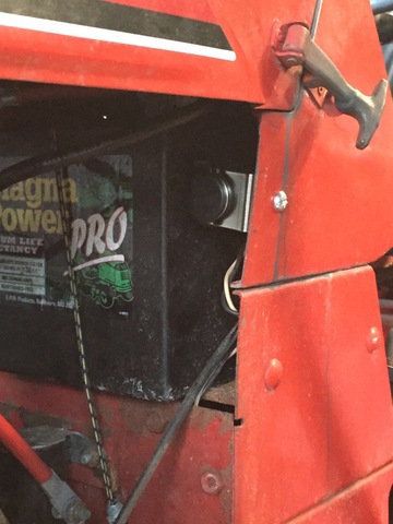

SylvanLakeWH 32,589 #1 Posted March 25, 2016 Decided to add a power plug to the C 105 so I can hook up chargers, spotlight, etc. as well as my portable flashing beacon for night time plowing. My son drives on neighborhood streets to a couple of his plow jobs so flashers are good! Tucked in real nice, out of the weather, and works like a champ! 7 Share this post Link to post Share on other sites

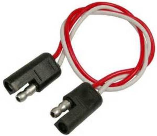

squonk 48,141 #5 Posted March 26, 2016 I use these plugs on all my tractors. A little more weatherproof and a more secure connection. I just install one half of the plug on whatever I want connected. Tenders, defrosters, lights, microwave ect. I also use the flat black rubber bungees instead of the corded ones. Corded ones get a bit chafed after a while! 3 Share this post Link to post Share on other sites
SylvanLakeWH 32,589 #6 Posted March 26, 2016 16 minutes ago, squonk said: I use these plugs on all my tractors. A little more weatherproof and a more secure connection. I just install one half of the plug on whatever I want connected. Tenders, defrosters, lights, microwave ect. I also use the flat black rubber bungees instead of the corded ones. Corded ones get a bit chafed after a while! Good idea (better than mine! But I had the power port already and being shall we say - cheap - I liked it as the preferred option...)...OOOOHHHH...But wait, the kids iPhone doesn't use that connector and...what's a kid to do out there mowing / plowing when they lose juice and the tunes stop..and then they can't text...or check snapchat...or instagram...or post a picture to Redsquare...or... 5 Share this post Link to post Share on other sites
tunahead72 2,662 #7 Posted March 26, 2016 11 hours ago, SylvanLakeWH said: Just woke up here, so I may be seeing things (again), but it looks like your battery is installed the reverse of what I'm used to seeing on my own tractors. Yours has the positive terminal on the left (in this photo) and the negative on the right, mine are the opposite. Just wondering, any particular reason? 2 Share this post Link to post Share on other sites
SylvanLakeWH 32,589 #8 Posted March 26, 2016 5 minutes ago, tunahead72 said: Just woke up here, so I may be seeing things (again), but it looks like your battery is installed the reverse of what I'm used to seeing on my own tractors. Yours has the positive terminal on the left (in this photo) and the negative on the right, mine are the opposite. Just wondering, any particular reason? Come to think of it, me thinks you are correct. Nope - no reason...Came that way from PO and never thought about it. Don't think it matters does it? I do have red to red and black to black so at least give me some credit!!! As I am fond of telling my kids - "Your Dad ain't the brightest bulb in the chandelier..." 1 Share this post Link to post Share on other sites

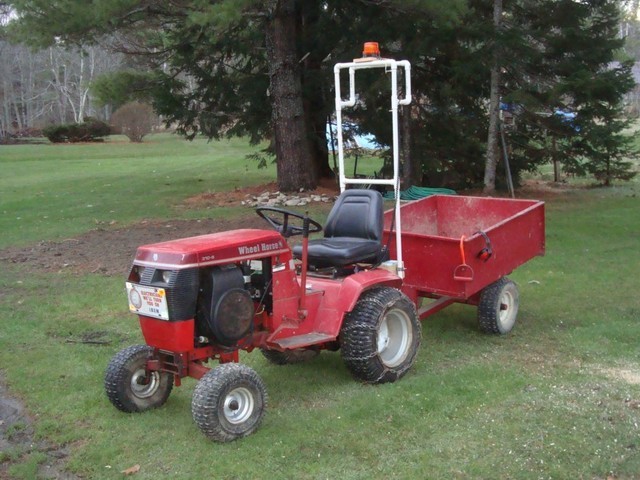

Retired Sparky 526 #10 Posted March 26, 2016 13 hours ago, elcamino/wheelhorse said: Like the battery hold down did that come as standard equipment or did you have to pay extra ? Power plug is a good idea. May install one on worker for snow. 13 hours ago, elcamino/wheelhorse said: Like the battery hold down did that come as standard equipment or did you have to pay extra ? Power plug is a good idea. May install one on worker for snow. I put this on my tractor 4 yrs. ago. It has it's own power source behind the seat. I found the strobe was affected by the ignition pulse. The faster the engine would run the faster the strobe would flash. So independent power. The batt. is seven yrs. old so I just put it on a trickle charge every night. 2 Share this post Link to post Share on other sites
tunahead72 2,662 #11 Posted March 27, 2016 16 hours ago, SylvanLakeWH said: Come to think of it, me thinks you are correct. Nope - no reason...Came that way from PO and never thought about it. Don't think it matters does it? I do have red to red and black to black so at least give me some credit!!! As I am fond of telling my kids - "Your Dad ain't the brightest bulb in the chandelier..." I think you're right, it probably doesn't matter, as long as you have the cables hooked up correctly, which you do. It looks like your positive cable is a good bit longer than it would be the other way, but I suspect the PO had what sounded like a good reason at the time. 1 Share this post Link to post Share on other sites

Save Old Iron 1,573 #13 Posted March 27, 2016 18 hours ago, SylvanLakeWH said: Don't think it matters does it? only if you use a metal battery hold down. the offset [front to back] of the terminals requires the battery be oriented properly so the hold down would not touch and short out the battery terminals to chassis 3 Share this post Link to post Share on other sites
SylvanLakeWH 32,589 #14 Posted March 27, 2016 4 hours ago, Save Old Iron said: only if you use a metal battery hold down. the offset [front to back] of the terminals requires the battery be oriented properly so the hold down would not touch and short out the battery terminals to chassis Never knew or thought of that! Thanks! Of course, with my special, optional, deluxe Bungee Cord hold down I think I'm safe from shorting out... 1 Share this post Link to post Share on other sites
