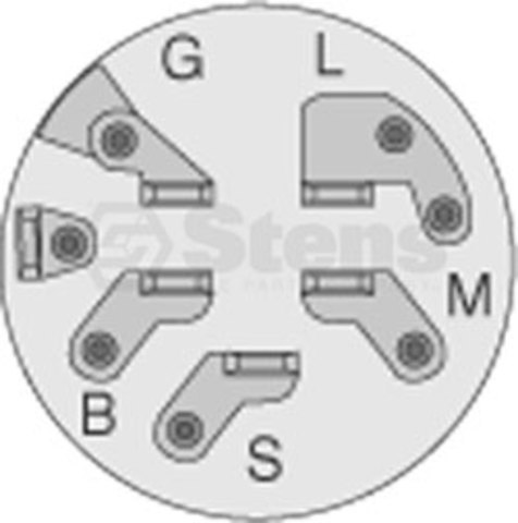

953 nut 63,003 #2 Posted March 25, 2016 Are you using the same ignition switch that was on the tractor before you started the restoration? Your diagram shows a green wire from the switch to the magneto, the switch will short this wire to ground when the switch is in the off position, other than that it should show infinite resistance to ground. Share this post Link to post Share on other sites

wallfish 18,786 #4 Posted March 25, 2016 Do not supply ANY power to that magneto coil. That could be why the last one failed. The GROUND wire to the switch from the magneto should connect to the "M" post on the switch. You may need to pull that switch and look at the letters next to the posts on it to confirm it's the correct switch and/or if it's connected to the right post. Can you explain what tractor and engine you are talking about? 1 Share this post Link to post Share on other sites

russellmc301 601 #7 Posted March 25, 2016 the green wire from the key comes down and connects to it and it has a charge so how do i make that one ground? Share this post Link to post Share on other sites
953 nut 63,003 #8 Posted March 25, 2016 If the green wire has voltage on it then there is a problem. Disconnect it, put tape on it to keep it safe. Run a wire from the mag wire to a toggle switch, that switch will go to ground. With the switch in the "off" position your mag should produce a spark at the plug, switching it to "on" will short the mag. to ground and stop the engine from running. Share this post Link to post Share on other sites
