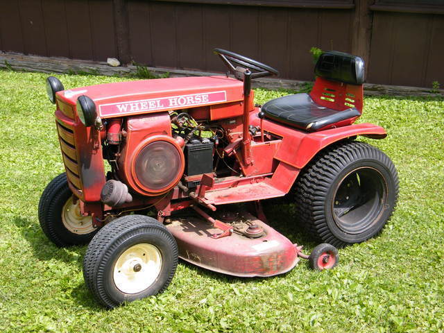

Wheelhorse100 3 #1 Posted March 25, 2016 (edited) Hi I have a wheel horse raider 10 . With a 12 horse Kohler. I'm looking to do some pulling with it. If I jack it up and spin the tire one way and other tire spins in the opposite direction. Will the transmission hold up or should I replace it, with a stronger one Edited March 25, 2016 by Wheelhorse100 Share this post Link to post Share on other sites

stevasaurus 23,420 #5 Posted March 25, 2016 So what year or model number is your Raider 10 with a 12 hsp Kohler?? The Raiders, through the years came with a 4 pinion with 1" axles...a 5071 (6 speed) and the 5073 (8 speed). Your model number will tell us which one you have there. Do you have a hi/low option on your transmission?? Do you have 1" or 1 1/8" axles?? Is the brake drum shaft in the hole closest to the axle housing or in the next hole toward the front of the transmission?? 1 Share this post Link to post Share on other sites
Wheelhorse100 3 #6 Posted March 25, 2016 It's a 1972 wheel horse raider 10. The original ten horse had a cracked block. So I replaced it with a 12 horse Kohler. The transmission has hi and low. It has 1 inch axles 1 Share this post Link to post Share on other sites
stevasaurus 23,420 #7 Posted March 25, 2016 OK...that is the #5086 transmission. That has a 4 pinion differential and 1" axles. Nothing wrong with the transmission as far as pulling, but if you are going to get serious about it...you want an 8 pinion differential with 1 1/8" axles. I would stay away from a 10 pinion limited slip differential for pulling. Differentials to look for...5091, 103907, 103916, 103918. 2 Share this post Link to post Share on other sites
