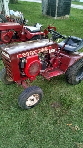

mikeeyre74 290 #1 Posted March 24, 2016 I guess the title sorta says it all, but I've got a B-80 (1977) with the original engine.. and a friend of mine has an Allis Chalmers 314 with the Kohler k321 in it that he's junking.. the engine is supposedly still good. Is it possible, and what would I need parts-wise, to make this swap happen? I'm not really looking to do it super fast.. the k181 works like a champ right now, but just so I can have this on standby if I need it, and then keep a look out for any necessary parts I'd need, what.. well, what would I need? Share this post Link to post Share on other sites
rmaynard 17,221 #2 Posted March 24, 2016 If the K321 sits with the crankshaft at the right height and distance from the transmission input shaft, you should be okay. Also, the shaft of the K181 was 1" and the K321 will probably be 1-1/8", so some PTO modifications may be necessary. Share this post Link to post Share on other sites
slammer302 2,157 #3 Posted March 24, 2016 I have a B-80 4speed with a k241 on it. It bolted right up but the muffler barely cleared the hood. The frame on my B-80 is a little shorter than a C series but most B-80's have the same length frame as a C series just depends what year yours is. you may need longer throttle and choke cables. I would use the 8hp kohler as long as you can 1 Share this post Link to post Share on other sites
