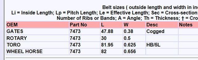

daveoman1966 3,884 #4 Posted March 22, 2016 Are you using the right drive belt. The OEM belt is # 7473. If using an after-market belt, that MAY be the problem. 1 Share this post Link to post Share on other sites

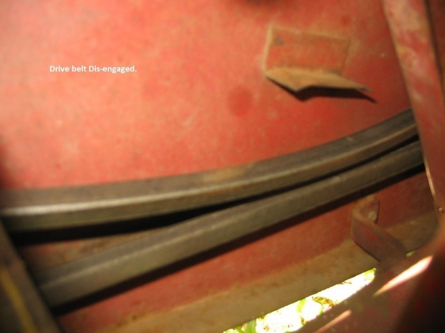

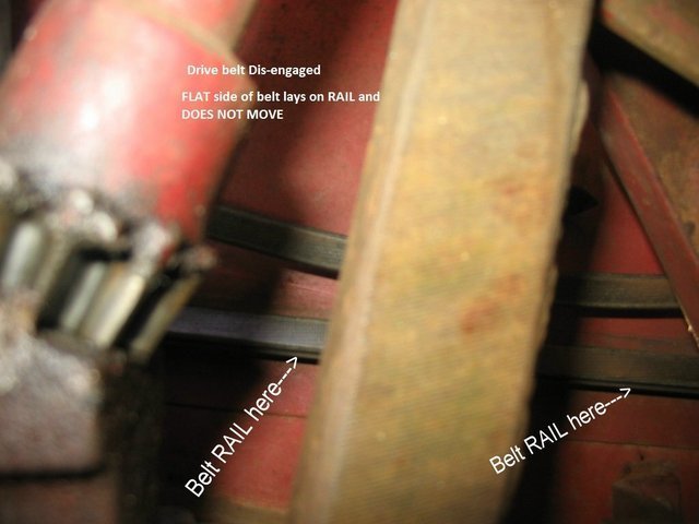

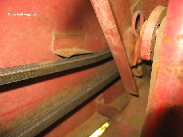

rmaynard 17,548 #5 Posted March 22, 2016 Do you have the belt cover on? Guides on the cover assist the belt in disengaging from the drive pulley. 1 Share this post Link to post Share on other sites
daveoman1966 3,884 #6 Posted March 22, 2016 3 minutes ago, rmaynard said: Do you have the belt cover on? Guides on the cover assist the belt in disengaging from the drive pulley. Pics of belt cover guides.... Share this post Link to post Share on other sites
