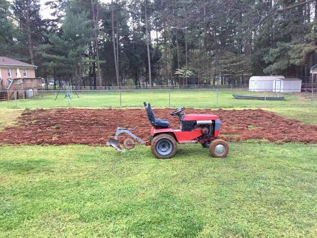

DougL3 63 #1 Posted March 22, 2016 (edited) So I plowed for the first time ever on Saturday, as I've done nothing but use a walk behind tiller in the years previous. Never again I say, from here forward it will be done from the luxury of a tractor seat! I must have picked the perfect time to plow because it was super easy to turn the dirt. I'm on turf tires, no weights, and no chains. I only had to back up 3 or 4 times. I did run into a slight issue though. I gauged myself off of the front wheel in the furrow, which in turn left me with ridges between each furrow that are the same width as the front tire. Should I have been gauging myself off the rear tire? That's what it seems like to me! Here's a pic of this years plot...I'll post a pic of the "ridges" when I get back home. Here is a pic of the rear of the 520...makes me think about running narrower wheels and tires. Edited March 22, 2016 by DougL3 7 Share this post Link to post Share on other sites
Ed Kennell 47,054 #2 Posted March 22, 2016 Were you running the front tire in the furrow, or up on top to the left of the furrow? Running in the furrow should been the right spacing. Share this post Link to post Share on other sites
DougL3 63 #3 Posted March 22, 2016 I was running in the furrow. Inner sidewall of the tire rubbing the left wall of the furrow...but the rear end of the tractor was level with the yard. It never felt like the back tire was down in the furrow with the front. Share this post Link to post Share on other sites
Ed Kennell 47,054 #4 Posted March 22, 2016 Yeah, the wide rears may be part of the problem then. Do you have a narrow one you could try on the right side? You could also move the plow right by using the left hole in the clevis and then tighten the left 1/2" bolt in the hitch to throw the plow more right. 1 Share this post Link to post Share on other sites

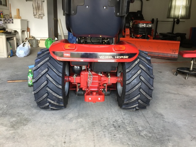

tractorhogg 667 #11 Posted March 22, 2016 (edited) 3 hours ago, C-101plowerpower said: i'd go for a set of 8.50x23 ags, 6-12 may be a little on the narrow side. as for the plow, it looks nice and shiny smooth now, keep it that way by cleaning the dirt of and greasing it up, otherwise you will need ag's and wheights next time horse looks happy about the result too Koen's right, the 8.50 AG's will fit on your rims nicely and be great for AG work. 6-12 are great for smaller wheel horse tractors, but I think the 8.50's will be better on this size of WH, even better that you don't have to buy rims 7 hours ago, DougL3 said: So I plowed for the first time ever on Saturday, as I've done nothing but use a walk behind tiller in the years previous. Never again I say, from here forward it will be done from the luxury of a tractor seat! I must have picked the perfect time to plow because it was super easy to turn the dirt. I'm on turf tires, no weights, and no chains. I only had to back up 3 or 4 times. I did run into a slight issue though. I gauged myself off of the front wheel in the furrow, which in turn left me with ridges between each furrow that are the same width as the front tire. Should I have been gauging myself off the rear tire? That's what it seems like to me! Here's a pic of this years plot...I'll post a pic of the "ridges" when I get back home. Here is a pic of the rear of the 520...makes me think about running narrower wheels and tires. That sandy soil ya'll got down there is what makes for easy plowing. Up north soil is plowed like you would cut a brisket, down your way it's more akin to pulling a ladle through gravy. Edited March 22, 2016 by tractorhogg Share this post Link to post Share on other sites

tractorhogg 667 #14 Posted March 23, 2016 3 hours ago, Phatboy said: All ya have to do is line up the plow share with the inside of the right tire.. Which is the part that digs into the ground, you want to line the far right edge of that with the inside of right tire..and it wont matter what size tires you are running in the back,, 23/10.50-12 stock size on a 520H,, you can see tire and rim are exactly even on inside so putting a thinner tire wont make a difference ,, A narrower tire will drop into the furrow where as a wide tire has trouble. I believe the first post made mention of that fact.. Wide tires are great for "pulling", discing, and a few other jobs but they aren't the best for plowing, that's why farm tractors don't look like hot wheels cars the way some garden tractors do, well unless they are "pulling" tractors. Cool is fine, but functional is important to perform other functions than just looking goo.. I would use a narrow front tire as well, like 4.00-8 tri-rib as wide. balloon turf tires aren't suited for plowing, but I'm sure someone might tell me they are Share this post Link to post Share on other sites

6wheeler 676 #24 Posted March 25, 2016 Move to the right so the rear tire is in the furrow. Use the front wheel to steer, keep the rear in the furrow. Also, your plow shined up nice(even to the heel of the moldboard) so it is taking a nice cut. If your ground is relatively sandy and you can go faster? Do it. As long as the heel of your plowshare is even or close to even with the inside wall of the furrow? It is set right for its cut. Tires are just a matter of opinion. I run turfs on my 520 pulling a 12" inch plow. If I get slippage? I throw chains on. I have ags on the D-250 because I do not mow with it. I put very skinny ags (walk behind tractor tires) on my 312h for cultivating between the rows (to narrow the tractor up as far as possible) so I can "fit" between the rows. If it is a little wet when you plow? Or, you are cutting sod? The furrows may not fill. The plowed ground may stand in ridges rather than roll over. This can even happen with the big equipment when plowing old alfalfa or pastures. Sometimes if you can go faster? You may be able to "throw" it over. However, plowing wet ground can make it very hard when it dries out. Making it hard to break up the clods. Discing it after does work but still leaves clumps sometimes. It looks like you have an 10" plow there. I think if you run the R/R tire in the furrow? You will see a big difference. Good Luck. Happy Gardening Pat 1 Share this post Link to post Share on other sites
