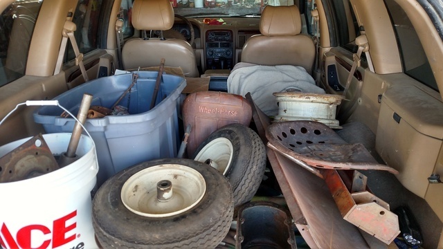

seven 202 #1 Posted March 21, 2016 Picked up at suburban finally!! (350)found one nearby it's all taken apart cause the guy was going too restore but he decided to sell it instead. Says everything is there I was wondering if someone could help me find a parts diagram for it , even the tranny is all apart .cause he said it needed new seals. 11 Share this post Link to post Share on other sites
ol550 844 #2 Posted March 21, 2016 (edited) It's like most puzzles but you need to start from the middle and work your way out. Check the manuals section for your diagram. Edited March 21, 2016 by ol550 2 Share this post Link to post Share on other sites

Racinbob 12,796 #4 Posted March 21, 2016 This will help you out. You don't need to open the transmission to replace the seals but it sure doesn't hurt to inspect everything. Don't forget pictures when you get started. 1 Share this post Link to post Share on other sites
oliver2-44 11,242 #5 Posted March 21, 2016 That seems to be my kind of tractor PARTS & Pieces! Rims & hood look to be in good shape, good luck with the rebuild 1 Share this post Link to post Share on other sites
Tankman 3,528 #6 Posted March 21, 2016 Easier to prep 'n paint! Don't forget to use Never-Seez on all that hardware. Share this post Link to post Share on other sites

TDF5G 2,073 #9 Posted March 21, 2016 That looks like the best puzzle money can buy! You need to buy a completed one to see where everything goes! Share this post Link to post Share on other sites
seven 202 #10 Posted March 21, 2016 Ya I will say a few hail Mary's and go for it yes it's got a snow blade hopefully all the pieces are there .starting with transmission first. The engine turns over and has compression. Probably do valve job and new piston an rings also then if all is there paint or possibly powder coat 3 Share this post Link to post Share on other sites
