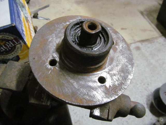

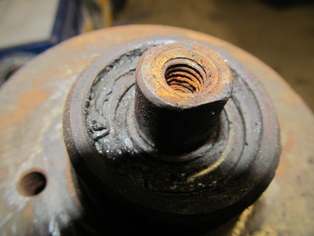

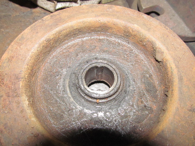

Ed Kennell 47,618 #4 Posted March 17, 2016 (edited) I just removed one from an older 48" deck. This was the old style side drive deck. It was held on by a 3/8 -16 HHCS that actually locks the pulley on the shaft with the shoulder on the bottom of the pulley fixing the inner race of the upper bearing to the shaft. The shaft and the pulley each have a flat on each side that prevents the pulley from turning on the shaft. My pulley came right off when I took the 3/8 " bolt out. Hope this isn't too confusing. I can take pics tomorrow if you want. Edited March 17, 2016 by ekennell 1 Share this post Link to post Share on other sites
randyh 4 #5 Posted March 17, 2016 picks would be good not sure what a side dive is mower probably from the mid 80s thanks dont see any bolts Share this post Link to post Share on other sites
Ed Kennell 47,618 #6 Posted March 17, 2016 (edited) 10 hours ago, randyh said: picks would be good not sure what a side dive is mower probably from the mid 80s thanks dont see any bolts Before WH started using the front mule drive in the early '70s, the mower drive belts went straight down from the engine PTO with a tensioning pulley on the side of the tractor. I believe the pulley bore should look like the shaft with the two flats. Most of the flats in the pulley bore have just worn away with time probably due to a loose bolt. Edited March 17, 2016 by ekennell Share this post Link to post Share on other sites

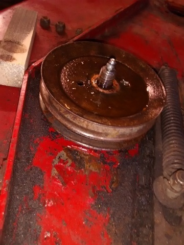

randyh 4 #7 Posted March 18, 2016 Here is what I am dealing with Share this post Link to post Share on other sites
Ed Kennell 47,618 #8 Posted March 18, 2016 I think they that one is just pressed on. Those pressed steel pulleys are difficult to get off without bending the flanges. May be try twisting to break it loose. Block the blade and use a strap wrench on the pulley ? You may have to put a piece of old V belt in the pulleys to get the strap wrench to grip. I hope these are cheaper than the cast pulley #106848 that I need. $173 from parts tree and or $143 from Jacks small engine. Share this post Link to post Share on other sites
Ed Kennell 47,618 #9 Posted March 18, 2016 Maybe a large bearing separator would work either under the pulley if you have room or in the pulley Vee groove. It could give a gear puller something solid to pull against. Share this post Link to post Share on other sites
slammer302 2,157 #10 Posted March 19, 2016 1 hour ago, randyh said: Here is what I am dealing with I've had luck using a tap to make threads in the two holes in the top of the pulley so I can screw two long bolts into them and use my fly wheel puller to pull it off. You will have to remove the grease zerk to do it this way but it works and saves the pulley. Share this post Link to post Share on other sites
randyh 4 #11 Posted March 19, 2016 OK, problem solved. I had this thing soaking in PB Blaster since monday,it wasn't budging. I decided to take a chance on something radical. after looking at some exploded views of the deck I removed the grease fitting, placed a block of hardwood on top of the shaft and gave it a hard rap with a hammer to drive the shaft down through the bearing housing. It worked. Should have tried it sooner. Thanks to everyone for the suggestions Next time someone has this problem I hope this helps them 2 Share this post Link to post Share on other sites
