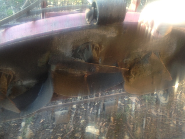

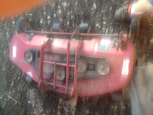

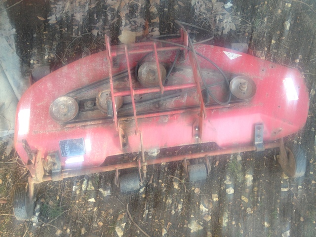

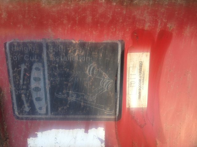

Tim1986 3 #1 Posted March 15, 2016 I'm needing help identifying what model my deck is. I need to purchase new blades but I'm not sure where to start since the model number tag is missing. All I know is it is a 48 inch deck. It came with my 1970 gt-14 but I don't believe it is the original deck. Any info would be greatly appreciated.thanks. Share this post Link to post Share on other sites
gwest_ca-(File Mod) 12,263 #2 Posted March 15, 2016 If your blades have a 3/4" round center hole this is an early model that used them 16-1/16" long 3-blade set from Toro # 106637 https://www.partstree.com/parts/search/parts/?searchTerm=106637 Napa 3 of # 7-04563 Oregon 3 of # 91-806 Oregon Gator Mulcher 3 of # 90-944 Oregon Gator Mulcher 3-in-1 3 of # 90-644 I looked for an early 48" deck that used the 106753 belt routing decal. Garry Share this post Link to post Share on other sites
