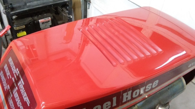

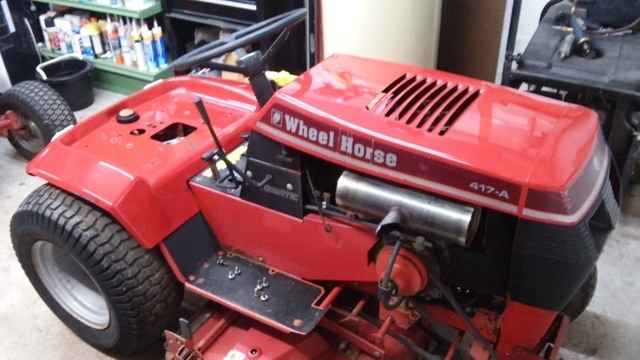

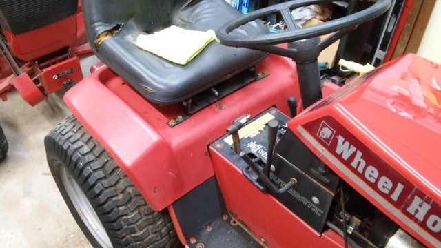

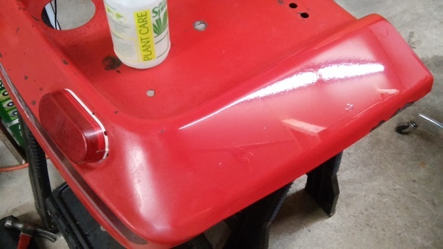

Theroundhousernr 590 #1 Posted March 15, 2016 ......what a little polish and buff wheel can do to tired old paint..... Still has a ways to go but should turn out pretty nice. 23 Share this post Link to post Share on other sites

Theroundhousernr 590 #10 Posted March 15, 2016 I dont use the more expensive stuff that I use on my truck. I keep it simple and anyone can do what I just did. I have a random orbital buffer and a high speed buffer. Pads and all kinds cutting compounds. I like to keep it simple when polishing on the tractors but on my new 520H I might go all out....lol. If you hit one spot of oil or grease, it makes a mess really quick of the pads. Plus, on this tractor there is a few chipped paint, rust spots so that can cause issues to. So I go to the hardware store or auto parts store and pick up a few wool buffing wheels with the quarter inch shank. They are around six inches in diameter and cost a few bucks. Then I just use a standard electric drill or even my dewalt battery drill. Also, the paint must be clean of all dirt and grime. Just washing won't work. Clay bar is the best but with this one, I cheaped out and just used a good microfiber and some mean green and really worked small areas until I got it smooth enough that I felt I wasnt going to do more damage then good. To get an idea of the dirt in the paint, take a plastic bag in your hand and run it over the paint. On dirty paint it will sound like your using sand paper. First- always season the wool wheel with whatever you are working with. Make sure the compound is really worked into the pad. Second- Keep a spray bottle of water with you. Spray the paint with a mist and the wool wheel also. Little trick I picked up along the way. Helps to keep things lubricated/lift dirt and also streches the compound a little fruther. Third- Work in small 12"x12' areas or smaller. When you move to a new section, add three or four more drops of polish and a spritz of water. Fourth- Move very slow. About an inch per second or so. You can really cut into the paint even with a drill and wool pad. Be careful, things can get hot but with this setup, its pretty safe. Fifth- Keep a clean microfiber around and wipe as you go. Six- follow up with your favorite wax. So for under twenty bucks and a drill you can get results like that. There is minor scratches when shining under a flash light that could be done better with better prep work and compounds. But I have to admit, I think this one will be moving on down the road. I need space badly. To many tractors....or not enough space. 3 hours ago, elcamino/wheelhorse said: What kind of polish are you using? Actually, I used a left over bottle of meguiars scratch remover 2.0 . That stuff works great on old faded paint but again if I was doing something nicer, I would use a cutting compound to fit my needs. 11 Share this post Link to post Share on other sites

Theroundhousernr 590 #14 Posted March 15, 2016 I agree. Sometimes people strip off paint that can look like what I just did. Then you see them on the online add sites with over spray everywhere asking top dollar for a "restored" machine.... 8 hours ago, stevasaurus said: That is the best explanation of the process that I have ever heard. Thanks for that. I tried to type as much detail as I could but didnt want some huge post. Maybe if there is interest, I could type up a info page on it. There are a few things left out but its more common sense type stuff. Showing both the proper way to do it and the way I just did it on the 417A. I am no professional by any means and with detailing, everyone has their own tricks and ways of doing it. Maybe include a video to . Who knows... 9 hours ago, jackhammer said: Looks Great On my 417 I've got a rubber seal around the inside of the bottom plate on the breather, Mines trashed. any idea of what I can replace it with?? thanks for the tips Rick The original seal, I think was more like a foam or soft rubber. Honestly, I would use something like a thick roofing rubber and cut your own. Or even EPMD like pond liner. Both should work fine for that. If I think of something different besides off the top of my head, I will send you an email. 2 Share this post Link to post Share on other sites
