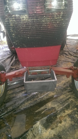

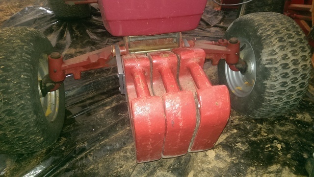

WVHillbilly520H 10,379 #9 Posted April 18, 2016 On 3/14/2016 at 11:40 PM, brandonozz said: I always wanted a strong lift on the back of this C as I thought it would be a great combination with the 8 speed. Only thing it needs now is more weight on the front. Fab you up one of my front weight hangers and add 3 43# suitcase weights... Just search here for classic front weight hanger I put the blue print on there as well...not making for anyone,Jeff. 1 Share this post Link to post Share on other sites
brandonozz 168 #10 Posted April 18, 2016 WVHillbilly, I like that hanger.... it looks nice and clean and I like the ability to quickly pull the weights to get the hood open. I've been thinking of building one of those and have been keeping an eye out for some weights on CL. Thanks, 1 Share this post Link to post Share on other sites
WVHillbilly520H 10,379 #11 Posted April 18, 2016 14 hours ago, brandonozz said: WVHillbilly, I like that hanger.... it looks nice and clean and I like the ability to quickly pull the weights to get the hood open. Brandonozz, if you check out my thread on here you'll see the hood does indeed open full tilt without removing any of the weights about 3/16" clearance at full open I designed it with that in mind as well portability and of course extra weight also it sticks out enough without the weights to be a bumper of sorts too and like I said the blue print is also posted, really isn't that hard to fab up if you can find the materials or have it made for you, thanks Jeff. 1 Share this post Link to post Share on other sites
