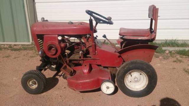

Leonard F. 14 #1 Posted March 11, 2016 Hello, I'm new here. So go easy on me... I purchased my first garden tractor, and I've attached pics. I don't know much about it, and I'm hoping some of you guys can help me with the specs. It looks early '60s to me, and the tires seem a little small. Anyway, any info is greatly appreciated. I found the remnants of a sticker on the tractor that reads: Serial Number 8496, and one on the mower deck that reads: Serial Number 9822 Thanks! 10 Share this post Link to post Share on other sites

Ed Kennell 44,530 #6 Posted March 11, 2016 8756 would be a 1970 Lawn Ranger. Any serial numbers on the engine? 4 Share this post Link to post Share on other sites
slammer302 2,156 #7 Posted March 11, 2016 Looks like a 64 Lawn Ranger with the round back fenders but maybe they have been added 1 Share this post Link to post Share on other sites

Terry M-(Moderator) 2,287 #16 Posted March 11, 2016 10 hours ago, slammer302 said: Looks like a 64 Lawn Ranger with the round back fenders but maybe they have been added Slammer is correct...What you have is a 1964 Lawn Ranger...it is the only year the lawn ranger had the long round hood with the little "clam shell" fenders. 8 Share this post Link to post Share on other sites

Ed Kennell 44,530 #21 Posted March 11, 2016 (edited) Could that engine model be H60-75063B. That's the engine in a '63 Lawn Ranger. Edited March 11, 2016 by ekennell 1 Share this post Link to post Share on other sites
Leonard F. 14 #22 Posted March 11, 2016 9 minutes ago, ekennell said: Could that engine model be H60-75063B. That's the engine in a '63 Lawn Ranger. Well, I just checked again. And this time I wore my glasses, and wouldn't you know it: Model H60-75063B Serial 3203 04668 1 Share this post Link to post Share on other sites

gwest_ca-(File Mod) 11,966 #25 Posted March 12, 2016 13 hours ago, Leonard F. said: Well, I just checked again. And this time I wore my glasses, and wouldn't you know it: Model H60-75063B Serial 3203 04668 According to this service bulletin the H60-75063b was only used in the 1964 34E Lawn Ranger and model 654. The fenders may be bolted on the wrong sides and be the reason they look odd. Garry 4 Share this post Link to post Share on other sites
