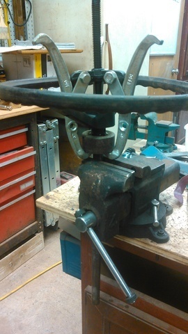

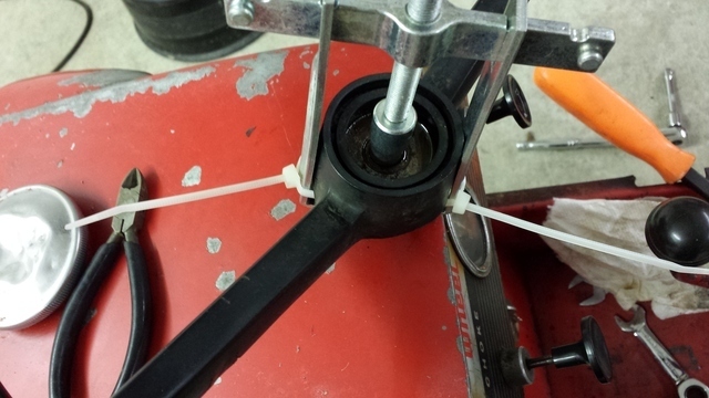

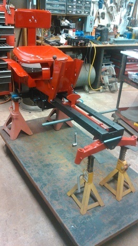

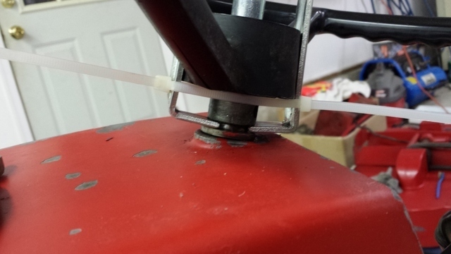

JPWH 6,544 #130 Posted February 25, 2016 (edited) I checked for transmission leaks and there are none so I added the rest of the parts that I had painted. Maybe it will warm up in the next few days so I can paint some more. I also shot some pb blaster on the steering wheel shaft that has been under pressure for about 3 days now. Edited February 25, 2016 by Hank01 5 Share this post Link to post Share on other sites
Aldon 4,832 #131 Posted February 25, 2016 That's looking Sharp Hank! 1 Share this post Link to post Share on other sites

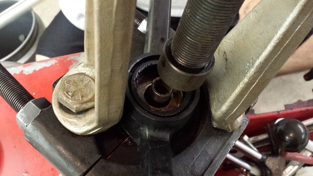

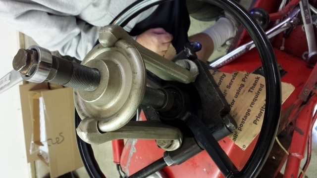

953 nut 68,697 #132 Posted February 26, 2016 2 hours ago, Hank01 said: the steering wheel shaft that has been under pressure for about 3 days now. Hank, have you tried using a pneumatic impact wrench on the puller/ The vibration seems to make them work better. 1 Share this post Link to post Share on other sites
JPWH 6,544 #133 Posted February 26, 2016 7 hours ago, 953 nut said: Hank, have you tried using a pneumatic impact wrench on the puller/ The vibration seems to make them work better. I did. My son brought one of those bearing puller set ups as well after I broke my first puller. I called the one machine shop where I live and he does not have a press so I did a little digging in my scrap metal and decided to build me one for pressing steering wheels. It has become personal with this particular steering wheel so I figured I will torture it for a while as it watches me build a press.LOL 2 Share this post Link to post Share on other sites
JERSEYHAWG / Glenn 4,589 #134 Posted February 26, 2016 (edited) 4 hours ago, Hank01 said: I did. My son brought one of those bearing puller set ups as well after I broke my first puller. I called the one machine shop where I live and he does not have a press so I did a little digging in my scrap metal and decided to build me one for pressing steering wheels. It has become personal with this particular steering wheel so I figured I will torture it for a while as it watches me build a press.LOL That's right, show em who the boss is. They are stubborn. Glenn Edited February 26, 2016 by JERSEYHAWG / Glenn 2 Share this post Link to post Share on other sites
JPWH 6,544 #135 Posted February 26, 2016 That rust weld is some durable stuff. 3 Share this post Link to post Share on other sites
rjg854 13,329 #136 Posted February 26, 2016 Did you take the roll pin out? 2 Share this post Link to post Share on other sites
JPWH 6,544 #137 Posted February 26, 2016 2 hours ago, Ranger13148 said: Did you take the roll pin out? I did and the one out of the Raider and have been using it that way. It's still holding. 2 Share this post Link to post Share on other sites
Aldon 4,832 #138 Posted February 26, 2016 11 hours ago, Hank01 said: My son brought one of those bepuller set ups as well after I broke my first puller. It has become personal with this particular steering wheel so I figured I will torture it for a while as it watches me build a press.LOL Been there...Done that. Absolutely have empathy for the war your currently engaged in. I broke at least 3 pullers and a few bolts last year which drove me to buy the monster hydraulic set up. Your mileage may differ but when I finally got the part free u was on cloud nine for at least a day. Wife already knew I was a bit off in head. I'm sure that my enthusiasm only cemented her opinion:-) I wish you luck ! 4 Share this post Link to post Share on other sites
DennisThornton 4,773 #139 Posted February 26, 2016 I'm thinking a torch, maybe even a propane while under tension. Or, if you can arrange it to get a large steel block under it and a serious smack with a big hammer might pop it off, sort of like popping a tie rod out. 2 Share this post Link to post Share on other sites

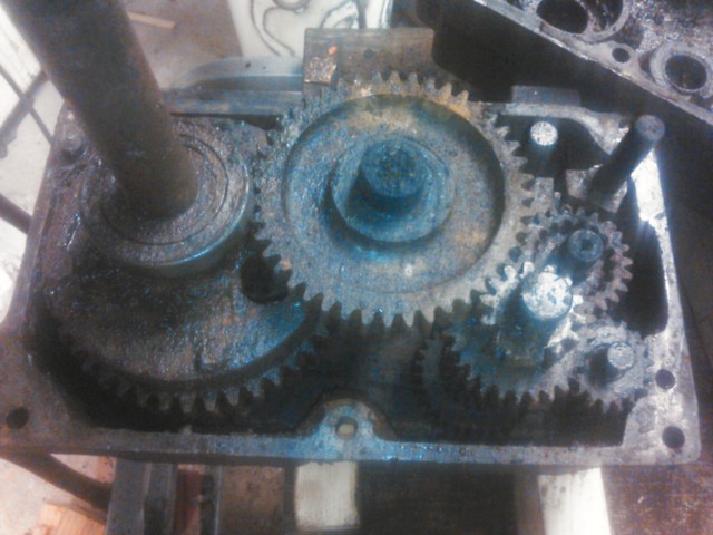

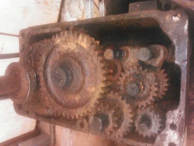

Retired Sparky 526 #140 Posted February 26, 2016 On 7/25/2015 at 10:24 PM, Hank01 said: I finally got the transmission apart. What a mess. It appears I will need to find alot of parts. I'll get it cleaned up and see what it really looks like. Can anyone tell what transmission this is. OMG. So what comes next. Do you soak them in hopes to put hem back into service, or do you order all new. I've never seen a gear box in such a state of corrosion. I'm in awe of some of you guys. Share this post Link to post Share on other sites
JPWH 6,544 #141 Posted February 26, 2016 21 minutes ago, Retired Sparky said: OMG. So what comes next. Do you soak them in hopes to put hem back into service, or do you order all new. I've never seen a gear box in such a state of corrosion. I'm in awe of some of you guys. I ended up using the input drive, shift rails, one small gear and the axles. My son had one tore down on a shelf so I got the housing and gears from that one and a gear from a RS member. All other bearings and seals new. 54 minutes ago, DennisThornton said: I'm thinking a torch, maybe even a propane while under tension. Or, if you can arrange it to get a large steel block under it and a serious smack with a big hammer might pop it off, sort of like popping a tie rod out. I have tried all that.This has been going on and off for a few months now. Good way to relieve stress.LOL 2 Share this post Link to post Share on other sites

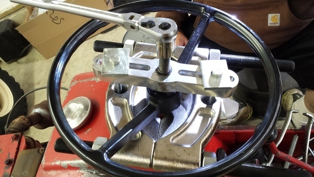

JERSEYHAWG / Glenn 4,589 #142 Posted February 26, 2016 Hank. my steering wheel battle mode. from mild to wild before it popped off. Glenn 3 Share this post Link to post Share on other sites
DennisThornton 4,773 #143 Posted February 26, 2016 1 hour ago, Hank01 said: I ended up using the input drive, shift rails, one small gear and the axles. My son had one tore down on a shelf so I got the housing and gears from that one and a gear from a RS member. All other bearings and seals new. I have tried all that.This has been going on and off for a few months now. Good way to relieve stress.LOL Well then, hotter torch and/or bigger hammer. It will come out with sufficient direction. 2 Share this post Link to post Share on other sites
DennisThornton 4,773 #144 Posted February 27, 2016 51 minutes ago, DennisThornton said: Well then, hotter torch and/or bigger hammer. It will come out with sufficient direction. I think that very often the details are overlooked when advice is given. Heat will help remove lots of things that are stuck. But folks will say I heated it and it stayed stuck. Didn't work! I have no memory of anything that stayed stuck after I heated sufficiently (but then my memory sometimes helps me with things I want to forget and recently all too often with things I want to remember too!) Anyway, heat is not the same as HEAT! Moderate heat often just doesn't work with really stuck stuff so HEAT needs to be applied. Cherry red and some force will remove about anything but cherry red isn't necessary all the time and often the whole port doesn't have to be cherry red. If one side of a nut, or collar or whatever is heated red it expands the whole which really improves the odds of removal. Usually a shaft can be persuaded to move right then, sometimes waiting until the red heat is gone will still work. Too easy to damage parts when they are red and quite forge-able but with care... 2 Share this post Link to post Share on other sites
buckrancher 2,697 #145 Posted February 27, 2016 (edited) many times I have heated a stuck part to cherry red and allow it to cool and then it will come apart easy as the heat carbonizes the rust between them Brian The early steering wheels that have the gear pinned on the shaft I remove the gear with a pin punch and put the wheel and shaft in a 20 ton hyd. press Edited February 27, 2016 by buckrancher 5 Share this post Link to post Share on other sites
JPWH 6,544 #146 Posted February 27, 2016 4 hours ago, Retired Sparky said: 20 minutes ago, buckrancher said: many times I have heated a stuck part to cherry red and allow it to cool and then it will come apart easy as the heat carbonizes the rust between them Brian The early steering wheels that have the gear pinned on the shaft I remove the gear with a pin punch and put the wheel and shaft in a 20 ton hyd. press Thanks for the size of press. I have a 20 ton bottle jack I plan to use as my press. Hank 2 Share this post Link to post Share on other sites
953 nut 68,697 #147 Posted February 27, 2016 Thinking outside the box, how about pulling the shaft as Brian suggest and putting the steering wheel end into an "E-Tank" and letting it dissolve the rust for you? I know that this isn't near as much fun as using a BFH and lots of heavy duty hydraulic pressure, but it could do the job. 1 Share this post Link to post Share on other sites
JPWH 6,544 #148 Posted February 27, 2016 I let it soak for about a week last summer when I first built the E tank. I figure the shaft is in the steering wheel about 11/4" and is probably rust all the way thru which has created a marriage with a very solid bond. I think I am going to enjoy this divorce one way or another. 1 Share this post Link to post Share on other sites
Aldon 4,832 #149 Posted February 27, 2016 I've never done the electro tank thing. Would a soak in the tank remove the rest seizing it together? 1 Share this post Link to post Share on other sites
953 nut 68,697 #150 Posted February 27, 2016 Another option comes to mind; some time ago Ed Kennell did a post about pulling a stuck hitch pin. He drilled a few holes in the gap between the pin and the transmission case and put PB Blaster in the drilled holes, that allowed deeper penetration. give it a try and if it works you owe @ekennell a royalty for his patented technique. 2 Share this post Link to post Share on other sites
