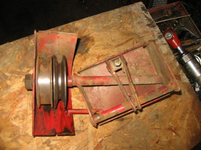

MAD MARK 74 #1 Posted March 10, 2016 My, what I am thinking you guys refer to as the "Mule Drive", guard for the mower belts is rubbing on the pulley on the right sitting on the mower. It is the set of the pulleys on the quick attach on the front of the mower. I tried to the mower deck for the first time since buying it and it started smoking like crazy. I thought maybe one of the pulleys up front was seized so I took them off and checked them ( they need replaced but fine for now ). Upon looking closer I saw that the guard has rub marks where the right pulley goes. Any reasons why? Bent guard? Wrong size Pulley?Any insight? Its the pulley circled in the picture below. My things went Guard > Spacer > Pulley > Spacer > Pulley Share this post Link to post Share on other sites

daveoman1966 3,884 #8 Posted March 10, 2016 Mule drive should look like this... There is a 'short' (1/2" ?) spacer between the two pulleys and a 'taller' one (3/4" ?) between the flat idler pulley and the outer half-moon shield. 1 Share this post Link to post Share on other sites

MAD MARK 74 #10 Posted March 10, 2016 This is the first time I ran the mower. I just bought this 312-8 last month and decided to see how everything was working/not working. My mule drive does look like that and the spacers are right. The picture I showed was a stock photo off of Google. I can take a picture of my drive later on with belt pics. I am 100% sure that the belt is not rubbing. It is the flat pulley rubbing against the mule guard. It rubs so long then gets bound up and stops thus making the belt smoke because the belt keeps rotating and the pulley is stopped. I've tried looking up the part numbers for the V and Flat pulleys but can't find those. Any help there? My nearest Toro dealer is over an hour away. Share this post Link to post Share on other sites
