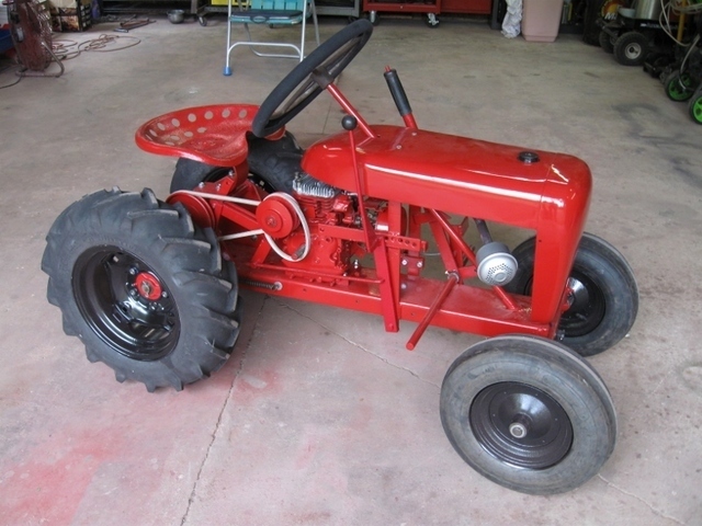

can whlvr 994 #11 Posted March 10, 2016 I know it can be daunting,i like tremclad paint,dont know if its in the states or not,i add a bit of hardener and its a bit slow but gives easy results ans holds up just fine for a working garden tractor,for 25 bucks worth of paint it works for me,heres a pic of it,regal red and a cheap spray gun 3 Share this post Link to post Share on other sites
