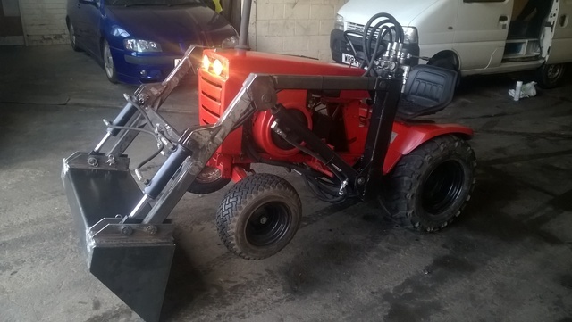

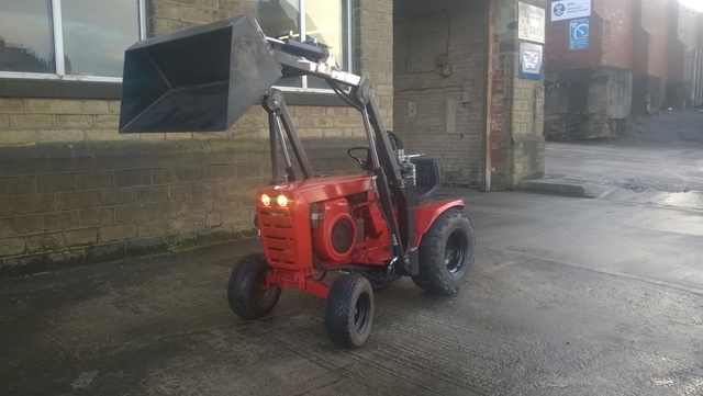

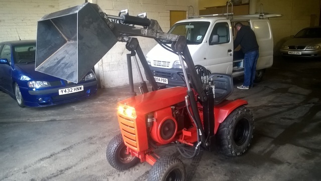

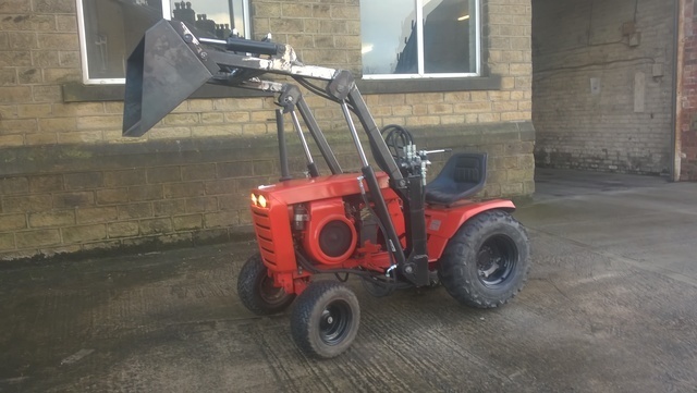

wheelhorse -ady 65 #1 Posted March 8, 2016 finished my front end loader 20 Share this post Link to post Share on other sites
TDF5G 2,051 #2 Posted March 8, 2016 That looks great! 3 Share this post Link to post Share on other sites
wheelhorse -ady 65 #3 Posted March 8, 2016 thanks mate 1 Share this post Link to post Share on other sites
AMC RULES 36,954 #4 Posted March 8, 2016 Good looking too. 2 Share this post Link to post Share on other sites

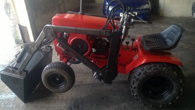

WNYPCRepair 1,875 #5 Posted March 8, 2016 Great job! Nice and beefy too! I hope mine turns out as well as yours. What thickness steel did you use for the bucket? 2 Share this post Link to post Share on other sites
MalMac 1,328 #6 Posted March 8, 2016 Looks good, do yourself a favor and get a cutting edge on that bucket. You have done such a nice job I would hate to see you mess it up. 3 Share this post Link to post Share on other sites
wheelhorse -ady 65 #7 Posted March 8, 2016 that some great advice I will.do that mate I build the loaders and sell them.im.fitting them to Bolens I have full.plans including part procurement and also for the rear hoe however this loader is my own design 60x40x5 for box for arms 80x80x5 for mounts and tanks and subframe 100x5 plates for joins ect cylinders are 60x50x30x500 stroke on arms cylinders are 60x50x30x150 for bucket pump is full hydo 20lpm 3000psi through my pto using 3/8 hoses and twin bank valve block im.building four for wheelhorses and one for a bolens i sell the loaders. On ebay i also make wheel weights for info on loaders , rear hoes and wheelweights myemail.is adrianrycroft@gmail.com.i can provide loader complete or as a kit to build yourself can provide at anystage of build 5 Share this post Link to post Share on other sites
elcamino/wheelhorse 9,068 #8 Posted March 8, 2016 That is a very nice loader. An excellent job. What model and year is the tractor ? 1 Share this post Link to post Share on other sites
wheelhorse -ady 65 #9 Posted March 8, 2016 hi mate its a fully restored 1972 raider 10 2 hours ago, WNYPCRepair said: Great job! Nice and beefy too! I hope mine turns out as well as yours. What thickness steel did you use for the bucket? 5mm steel folded twice with end caps seam welded on 1 Share this post Link to post Share on other sites
elcamino/wheelhorse 9,068 #10 Posted March 8, 2016 Not only do you have a nice loader but a beautiful tractor . Where is the pump for the loader , in front of the motor ? 1 Share this post Link to post Share on other sites
wheelhorse -ady 65 #11 Posted March 8, 2016 thanks mate I'm proud of er she's my advertising tractor for my wheelhorse website I build front loaders and other implements for them www.sosfab.co.uk is the address. My pump is mounted at the front near the pto at front of tractor and can be engaged and disengage through pto my cylinders twinned up can lift 3.2tons I have antifreeze I my rear tyres and also wheel weights to fit which I also sell 1 Share this post Link to post Share on other sites
wheelhorse -ady 65 #12 Posted March 8, 2016 I have a Kubota d950 diesel engine I'm looking at fitting into her next 1 Share this post Link to post Share on other sites

WNYPCRepair 1,875 #22 Posted March 9, 2016 No front to back bracing for the pedestals? 1 Share this post Link to post Share on other sites
roadapples 6,981 #24 Posted March 9, 2016 Looks great, how does it fasten with no base frame ? Share this post Link to post Share on other sites
wheelhorse -ady 65 #25 Posted March 9, 2016 no bracings' no there not required on mine due to how its built has chassis strengtheners and subframe mount Share this post Link to post Share on other sites
