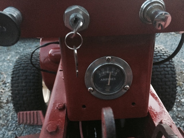

dells68 7,499 #29 Posted April 6, 2016 (edited) Hey guys. Update on the charging system. I decided to paint everything around the engine and reace a leaky head gasket. Pushed her out and she started right up and is showing almost 10 amps charging. Now I can venture into working on the sheet metal when I get a chance. I tried to upload a video of it running - we'll see if it works. Sorry, video doesn't work. Take my word for it, she sure sounds good! IMG_2336.MOV Edited April 6, 2016 by dells68 4 Share this post Link to post Share on other sites
WHX?? 57,958 #30 Posted April 6, 2016 Did you solder that regulator back up or replace it? Might be that it was just a bad spot on the foil and a high current draw opened it up. 1 Share this post Link to post Share on other sites

dells68 7,499 #33 Posted April 7, 2016 Sorry for the delay guys - testing time at school - even for my 2nd graders I didn't solder the original rectifier, just bought a new one from isavetractors. It is one of the 15 amp versions and is doing really well so far. I hope that continues. I've been trying to clean up the wiring a little as I go, and so far everything seems to work - except for the pto. Don't have any attachments for it so, I'll wait to switch it for a spare I have. I did check and it's getting full voltage and a good ground. The magnet will actually pull out when I unbolt the shaft bolt. Should it do this? The other one I have doesn't, but seems to have questionable bearings in the pulleys. Share this post Link to post Share on other sites
