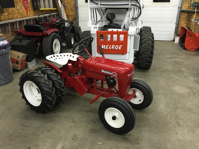

VogSe85 49 #1 Posted March 7, 2016 I purchased a very nice machine from SteveBo as my equipment needs are changing and so is my stable. I picked up a clean RJ58 and had to make it my own. I changed the Cliton engine base gasket, axle seals, found another set of rear wheels, got some tires and fabricated dual wheel adapters. I also fabricated a slot hitch adapter for towing misc and here's where I'm at... 12 Share this post Link to post Share on other sites

wallfish 20,090 #6 Posted March 7, 2016 Best to run those outside tires with 0 air pressure in them and maybe even higher than normal pressure for the inside tires. Those axle tubes will easily bend with the extra leverage from running duals on uneven ground. 3 Share this post Link to post Share on other sites

VogSe85 49 #8 Posted March 7, 2016 Still very cool machine!!! I will take your advice Wallfish and lower the outside tirepressures. Share this post Link to post Share on other sites

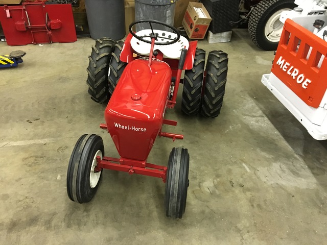

VogSe85 49 #13 Posted March 9, 2016 Check out the Classifieds... I listed the GT14 for sale. I'm hoping to expand my RJ collection instead and the word BABY has been getting thrown around a lot lately and I don't think she means it in the context as I...... Look at my new baby, my RJ58! 1 Share this post Link to post Share on other sites

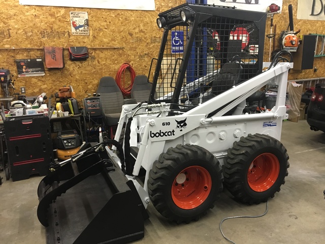

VogSe85 49 #14 Posted March 10, 2016 (edited) Put some ribbed tires on the front, decided to keep my RMR-32 mower so I put the belt guard back on so my pants don't get snagged on that pulley. Also an excuse to show off my GT-14 FEL and Bobcat 610 I restored! Edited March 10, 2016 by VogSe85 5 Share this post Link to post Share on other sites
stevebo-(Moderator) 8,695 #15 Posted March 11, 2016 Keeps getting better. That bobcat looks nice too Share this post Link to post Share on other sites
AMC RULES 37,259 #16 Posted March 11, 2016 Does look great... what brand are the tri-ribs? Share this post Link to post Share on other sites
VogSe85 49 #17 Posted March 11, 2016 They are Deestones D401 4.00-8 Thanks Steve! I'll sneak a quick one in... 1972 Bobcat 610 4cyl 30hp gas Wisconsin engine w/aux thumb 1 Share this post Link to post Share on other sites

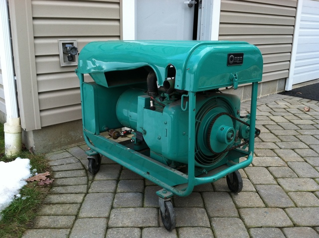

VogSe85 49 #18 Posted March 11, 2016 Since I'm on a roll of showing off my old equipment I've restored, 1 more thing before I get back to the RJ... Restored 1950 Onan Generator, back feed it through one of my welding plugs in my shop and can run the garage and house with this bad boy! 2 Share this post Link to post Share on other sites

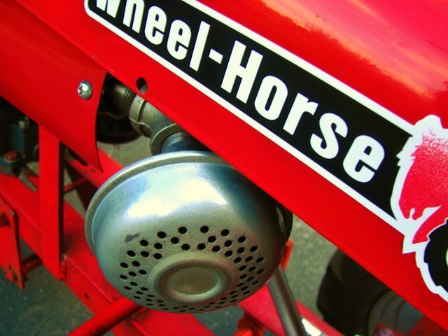

AMC RULES 37,259 #20 Posted March 11, 2016 To complete the look, now all you need is an OE shower cap muffler. 2 Share this post Link to post Share on other sites
stevebo-(Moderator) 8,695 #21 Posted March 11, 2016 I would like to get some more pics and information on that Onan starter set up. That is the same starter set up that I have on my electric start RJ35 which is missing the actual starter motor. Mine is chain driven too. 1 Share this post Link to post Share on other sites
VogSe85 49 #22 Posted March 11, 2016 That's awesome Steve! Remind me this evening and I'll take a bunch of pictures of it and see what numbers I can pull off it if any. 1 Share this post Link to post Share on other sites
VogSe85 49 #23 Posted March 12, 2016 Steve, no numbers but... 1 Share this post Link to post Share on other sites
stevebo-(Moderator) 8,695 #24 Posted March 12, 2016 What are the measurements on that one? Share this post Link to post Share on other sites
VogSe85 49 #25 Posted March 12, 2016 The body is 7"L 4.25"W shaft is 2 1/2"L 5/8"D sprocket is 8t Share this post Link to post Share on other sites
