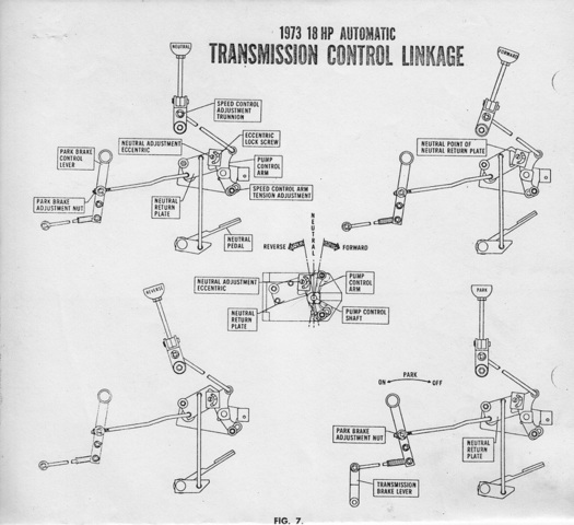

daveoman1966 3,884 #3 Posted March 5, 2016 Maybe these will help... Share this post Link to post Share on other sites

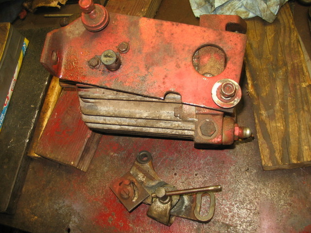

"D"- Man 827 #4 Posted March 6, 2016 Ivan, both of the 18 Automatics that I have owned are different than the linkage on my D-180. If it's nice out tomorrow, maybe I can take some pics. Share this post Link to post Share on other sites

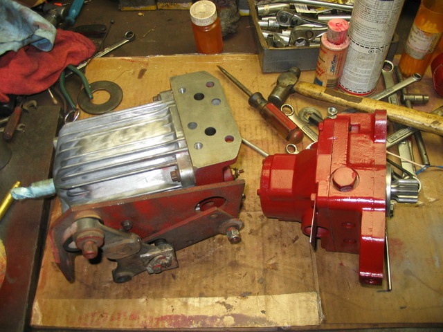

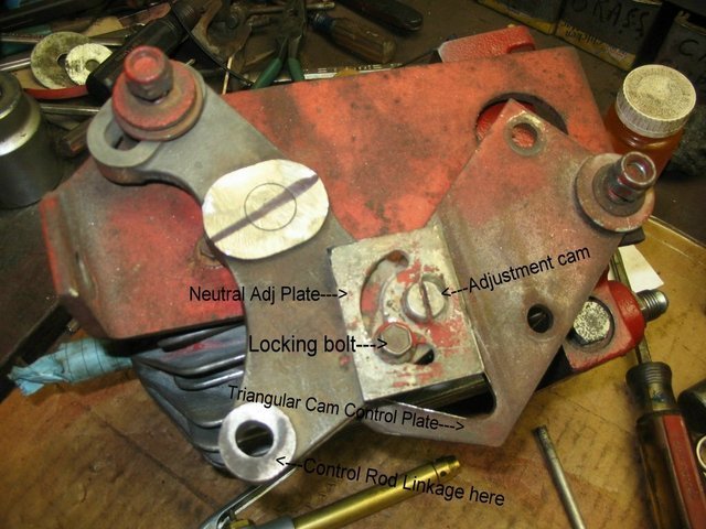

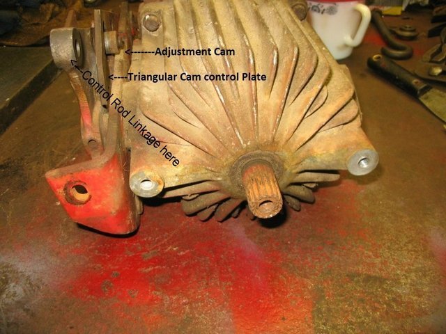

"D"- Man 827 #6 Posted March 6, 2016 When I stated that I would get pics I had no idea that after removing the side acess panel I would discover what appears to be an incomplete linkage. Keep in mind that this D-180 was bought used, and not running, so it is obvious that it may not function as intended. Share this post Link to post Share on other sites
