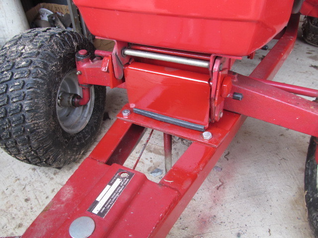

Ed Kennell 47,396 #1 Posted March 1, 2016 After 1 1/2 days of raking the stones out of the grass and back on the road, I was ready for a fun project. So this afternoon I made a blade centering device for the 312H. I also wanted to stop the hydro lift from pulling the plow frame up against the front axle, so I incorporated a stop into the centering device. Two 5/8" bolts salvaged from a utility pole, a piece of a scrap electrical panel door, a piece of old fuel line, and a piece of a worn out blade scraper bar. It was even warm enough to throw on a layer of Regal Red. 22 1 Share this post Link to post Share on other sites

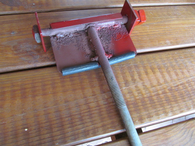

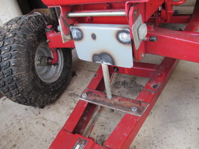

Phatboy 566 #5 Posted March 1, 2016 Can you take it off and post some pics of the back side so we might use it also, and get a good look at how its all put together, Please Share this post Link to post Share on other sites
Ed Kennell 47,396 #6 Posted March 1, 2016 (edited) I can, but I am not too happy with the appearance of the welds. The bolts were galvanized and although I ground it off in the areas I planned to weld, the zinc still contaminated the welds and caused a lot of splatter. I simply butt welded the two 5/8" bolts together in a TEE shape, then placed the TEE on the tractor and with the blade raised and got my width and height measurements for the gusset plate. Then I placed the TEE on the 1/16" steel plate and welded the bolts to the plate at their 3 ends. You can see on the unpainted pic where I concentrated the weld. I'll try to get you a pic tomorrow. Edited March 2, 2016 by ekennell 1 Share this post Link to post Share on other sites

Ed Kennell 47,396 #11 Posted March 2, 2016 Here's your pic of the ugly backside Phat. 4 Share this post Link to post Share on other sites
