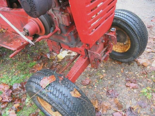

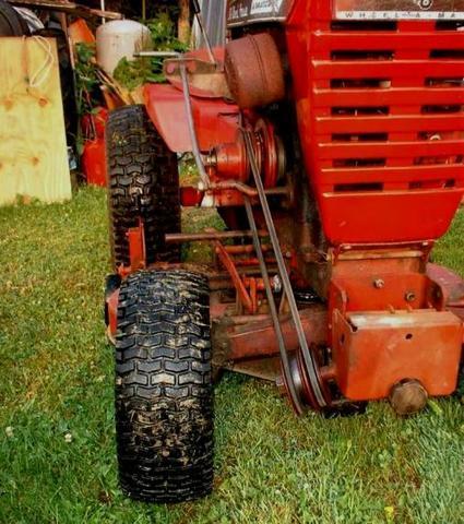

daveoman1966 3,883 #3 Posted March 1, 2016 You only need to upgrade the belt drive system on the tractor to be able to use most any 42" mower deck. I have an up-grade kit available and you can learn more about it by sending me a direct email. The kit upgrades to adapt your tractor to the Tach-o-Matic system where the belt runs out around the front axle, instead of the unwieldy contraption on the right side. Here it is on a Raider 10... and the parts to accomplish the upgrade.. My email address is: daveoman@windstream.net 1 Share this post Link to post Share on other sites
