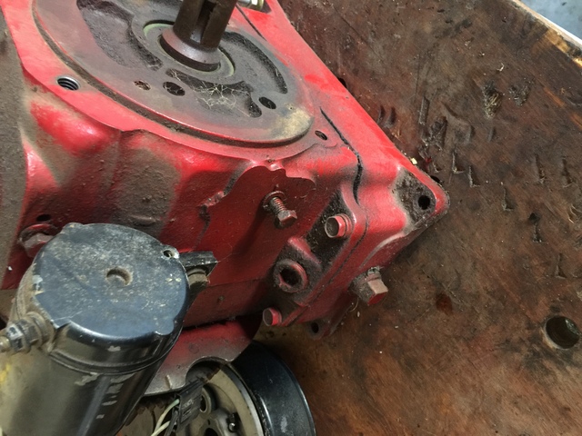

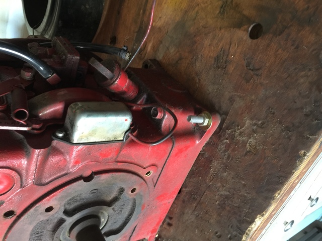

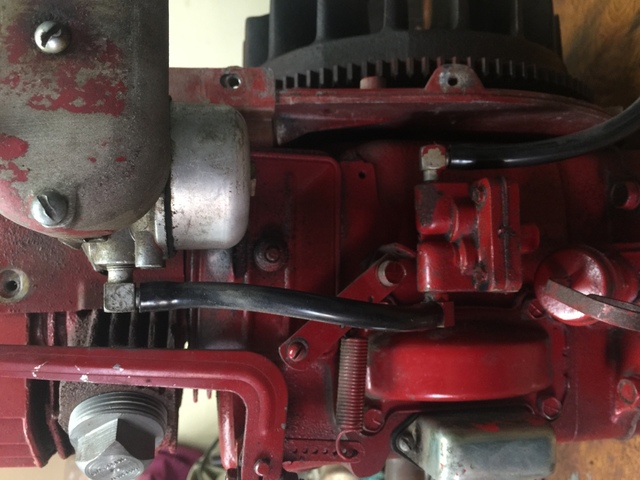

Aldon 4,832 #1 Posted February 27, 2016 Ok. Just getting ready to tackle a minor refresh in the engine that was on my GT14 when I got it. so it will end up being a GT14+2 Anyway, as can be seen in pic, the location of dipstick puts it basically under the gas tack shield with very little room to access. It looks like there is a plug in same space on the opposite side. Am I ok in assuming all I need do is swap them? The next thing I would like to know is whether there is a longer dipstick tube set up I could install to bring access out to the non PTO side of tractor for checking oil level and adding oil. Share this post Link to post Share on other sites

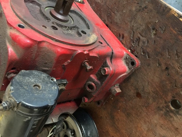

pfrederi 20,240 #2 Posted February 27, 2016 The longer dipstick on one of my 341 goes into the block about where the lonely bolt is in your last picture. You can see the casting has some flat space where other specs had the dip stick. So to answer your question yes you could use the other hole but not put in a longer dipstick..(that I am aware of) 1 Share this post Link to post Share on other sites

Aldon 4,832 #4 Posted February 27, 2016 It is a multiple year tractor. The engine was obviously a modification. If if a taller or longer dipstick can't be sourced from another Kohler model then I'll likely fabricate one. It it seems as long as the bend is not too severe I should be able to navigate around the starter. A potentially easier mod would be to lengthen the existing dipstick. Access is issue. So if I could extend it to the top area between engine/carb/gas tank shield that might be the bees knees.... Share this post Link to post Share on other sites

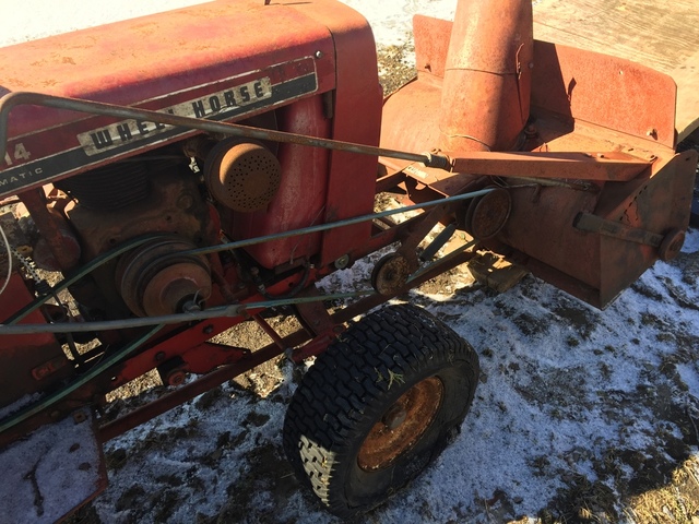

ztnoo 2,302 #5 Posted February 27, 2016 (edited) The tractor you just brought home looks like it has a tall filler pipe like mine. Edited February 28, 2016 by ztnoo 1 Share this post Link to post Share on other sites
pfrederi 20,240 #6 Posted February 27, 2016 ZTnoos dip stick looks just like mine. You can even see the small mounting bolt on the out side of the elbow would fit into the bump out on your casting (the little thing to the right of the bolt in your last picture) Share this post Link to post Share on other sites

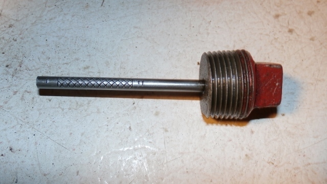

Gary L. 12 #7 Posted February 28, 2016 I changed K321 engines on my GT14 with an engine that came from a stationary unit, it came with a dipstick plug that will work under the starter ok if your hands aren't real large.. Gary L. 1 Share this post Link to post Share on other sites

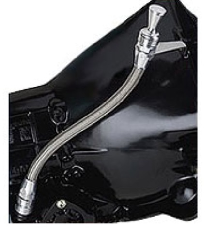

Aldon 4,832 #8 Posted February 28, 2016 So does anyone know off hand the female thread size or not for entry into block? There are some nice flexible tube set ups for aftermarket hot rods that may be a great addition if I can match up thread sizes. Share this post Link to post Share on other sites
pfrederi 20,240 #9 Posted February 28, 2016 If the head if the plug measures about 13/16 then it is 1/2"NPT (I have a K181 on the bench and that is what it has) The K301s341 That I can get to right now do not have that plug the have the dipsticks like Zitnoo or have the square head plug dip stick at the top of the crank case. Share this post Link to post Share on other sites

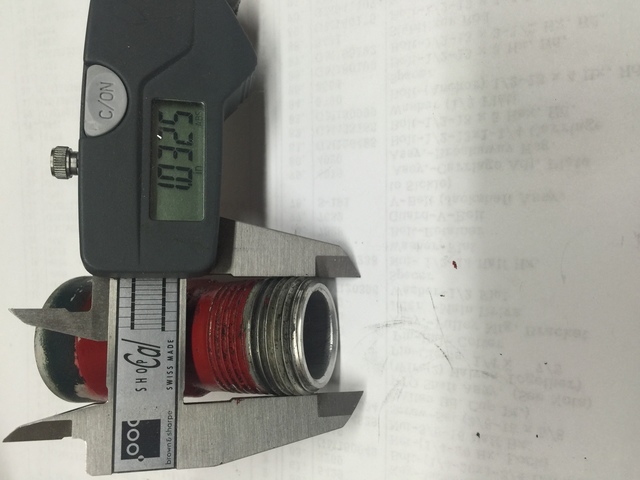

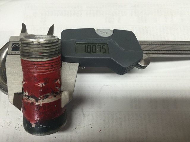

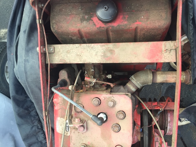

Aldon 4,832 #11 Posted February 28, 2016 I think I hve decided to try and route the Dipstick tube up the front. Here are pics with measurements actual. I am not good with NPT stuff so hopefully with these two pics someone will confirm my thread size. Also a pic from top of my other tractors which indicates enough space if I can locate a flexible dipstick tube to wind around the fuel pump and protruding rounded cover and in close proximity to exhaust pipe. Similar to route of fuel line. Luckily I rarely need to check oil while engine is at running temps. Share this post Link to post Share on other sites
pfrederi 20,240 #12 Posted February 28, 2016 That is bigger than half inch looks like 3/4" to me.... Look at this page on how to figure pipe sizes Pipe sizing 1 Share this post Link to post Share on other sites
ztnoo 2,302 #13 Posted February 29, 2016 (edited) Boy, the front end plumbing mod is a pretty tight fit......at least it looks that way to moi. The rear is more open and accessible to start off with, even with your existing filler, or for instance the angled one I posted above. A guy could reach in from the right (clutch) side and access the dipstick easier than replumbing the front threaded outlet port to get it up to almost hood level between the heat shield and the engine....... btw, what does that bolt do? what is its function on that tractor?? Edited February 29, 2016 by ztnoo 1 Share this post Link to post Share on other sites
Aldon 4,832 #14 Posted February 29, 2016 So the engine block on mine would need to be modified to install one like Yours Steve. That is just a threaded hole on mine. Something was bolted into it in its previous use there. So I am going to hve to navigate curves and bends regardless of whether I go with front or rear mounting. Here is what I am thinking.. As long as I can transition the base to the 1inch threaded entry into oil pan. Still searching options. Need to hit Napa or something. I do my best jury rigging when I can see and touch the components. Share this post Link to post Share on other sites
Aldon 4,832 #15 Posted February 29, 2016 So I am working on a plan. PTFE tubing with NPT compression fitting Male threads to match block once confirmed size to flared. Stainless braid covered or red or black opaque tubing. Thinking about using some sort of bulkhead fitting and making a hole in the fuel tank shield. Then find an aftermarket dipstick and fab up by using the original dipstick cap. The PTFE should provide a slick enough inner wall to allow the dipstick to slide easy. I can make dipstick to correct length with a little trial and error. Well that's the plan this evening. Never done one before but it seems this should work. Anyone feel this would not work? Share this post Link to post Share on other sites
ztnoo 2,302 #16 Posted February 29, 2016 (edited) Seems like you don't have much to lose scoping it out other than your time. The parts would reasonable (plastic fittings as opposed to cast fittings) to "get you where you want to go" ......... meaning an accessible place to the add oil and check for proper oil level. The tubing probably could be heated enough to bend slightly if needed for desired routing. Given you're pondering trying this, I would still consider using the rear port we discussed earlier. Its much more open on the rear of the engine than the front. Also a rear location would be more forgiving in terms of any oil spillage, as opposed to the front of the engine where there's a closer relationship with the fuel tank, the heat shield, and engine itself. If your materials go together as envisioned, you would end up with something looking very close to the OEM set up such as I have, but using a lower starting point (where the pipe plug is currently) than my filler tube. Why couldn't you reverse the fittings on the upper end (with a female fitting) and go ahead and use your existing short oil filler tube screwed into that? There's tons of long dipsticks like mine on eBay to either add to or clip off as needed. I'm pretty sure these have the same dipstick seal as what you current have. The longer dipstick itself would be the costliest item in this custom change. The flat stock dipstick, as opposed to a rod, would provide enough strength to allow it too push though the filler tube, yet be flexible enough to turn and make its way through any bends or slight curves you might need for clearance. Off a John Deere Kohler K321 Edited February 29, 2016 by ztnoo 1 Share this post Link to post Share on other sites

Aldon 4,832 #20 Posted March 2, 2016 I verified today at Fastenal that it is 3/4 NPT male thread. So I'll be doing up a draft parts list and order up components in next day or two. Share this post Link to post Share on other sites
