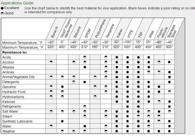

JPWH 5,314 #5 Posted February 28, 2016 Thanks for sharing this info. I have a question. Why is your preference Viton? Better quality or what? Share this post Link to post Share on other sites
Aldon 4,826 #6 Posted February 28, 2016 I too am prejudiced towards Viton. We use them in semiconductor manufacturing and they are routinely proven high quality. I am sure other brands may be as well, but I have higher confidence based on usage with Viton. am interested in pftederi response too 1 Share this post Link to post Share on other sites

pfrederi 17,173 #8 Posted February 28, 2016 I read (don't rmember where) that Viton rings were more resistive to transmission fluid. I use ATF in my older Sundstrands. This chart also shows they are better for synthetic lubricants (if I ever decide to change my D200 to Mobil 1 I will be ready) 2 Share this post Link to post Share on other sites
