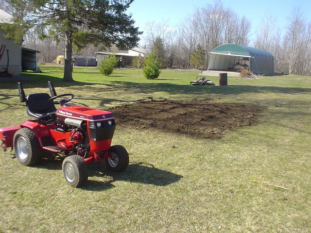

cleat 9,403 #17 Posted March 7, 2016 (edited) I did this last year with one of my 520-H's on sod and rock. First pass it tried to push the machine a bit so I did a 1/2 depth cut to grind up the sod Next pass was full depth. Matt's foot pedal kit makes all the difference. Edited March 7, 2016 by cleat 2 Share this post Link to post Share on other sites
