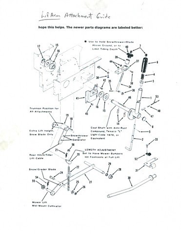

semper5 43 #1 Posted February 25, 2016 Many moons ago I ran across a diagram of what holes in the lift were meant for. One hole was better for the mower deck, one for the plow, etc. Does anyone have this diagram? Share this post Link to post Share on other sites

semper5 43 #3 Posted February 25, 2016 Almost, but it had the diagram of the attachment bar, and what implemts went to which hole. I am looking for the proper place for the lift tube. Share this post Link to post Share on other sites

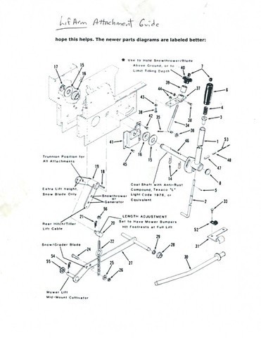

Lane Ranger 12,094 #4 Posted February 25, 2016 This is the Wheel Horse Lift Attachment Guide I use. I keep a three ring binder notebook for each tractor that I own. I made a copy for every three ring binder notebook I have. I 3 Share this post Link to post Share on other sites
oldredrider 2,553 #5 Posted February 25, 2016 Lane, I keep a copy attached to the fridge in the garage for quick reference. 1 Share this post Link to post Share on other sites
Lane Ranger 12,094 #6 Posted February 25, 2016 (edited) This is the Wheel Horse Lift Attachment Guide I use. I keep a three ring binder notebook for each tractor that I own. I made a copy for every three ring binder notebook I have. Oldredrider: I have to refer to this every time I move to another tactor with tractors from 1958 to 1993 and all the different attachments ! Edited February 27, 2016 by Lane Ranger 1 Share this post Link to post Share on other sites
